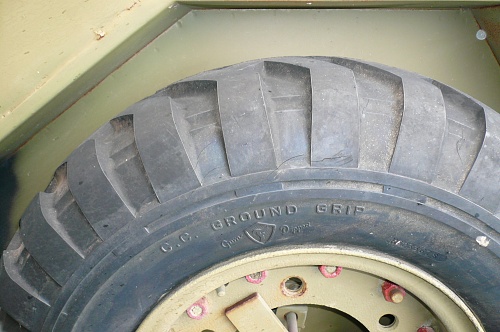

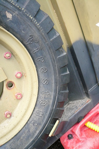

Over on "the other site", Mark Arnott asked me: "What was the original tyre manufacturer for CMPs?"
I know of one brand at least - see my pictures of a wartime Firestone Cross Country Ground Grip 9.25-16 tyre on a C8A HUP.
Who can add to this subject?

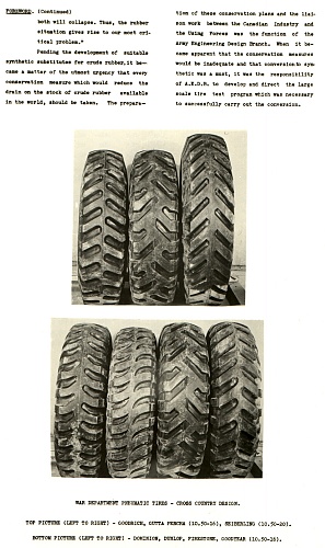

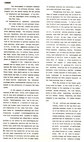

During WW2, the Australian Government purchased from several tyre manufacturers:
  • Dominion Rubber Co. - 9.00-16 and 10.50-20 cross country
  • Dunlop Tyre and Rubber Co: 10.50-20 cross country
  • Firestone Tyre Co cross country - size not specified
  • B F Goodrich Rubber Co
  • Goodyear Tyre & Rubber Co, including 9.00-16 RF and 10.50-20 cross country
  • Seiberling Rubber Co: 10.50-20 12 ply cross country
Most orders specified 'casings, flaps, tubes', casings being the tyre. The tyre sizes listed above are most probably not the only sizes supplied by these companies, not are they the only companies from which tyres were purchased - these are just the ones I have ordering data on.

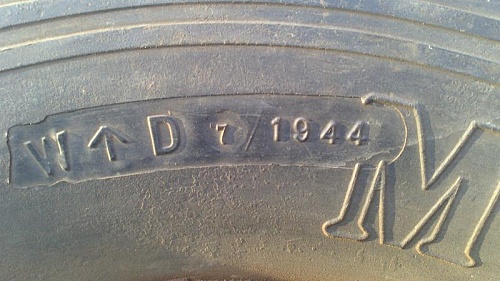

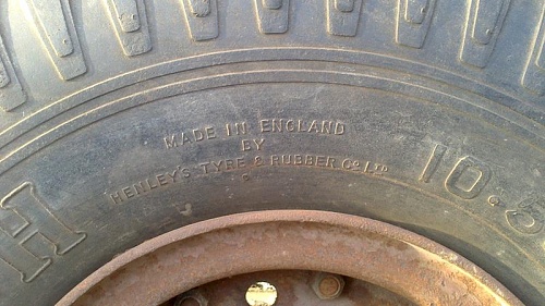

Here are some pictures of a 10.50-13 tyre dated 7/1944, manufactured for the War Department by Henley's Tyre & Rubber Co Ltd. I had not seen this brand before.

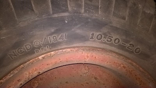

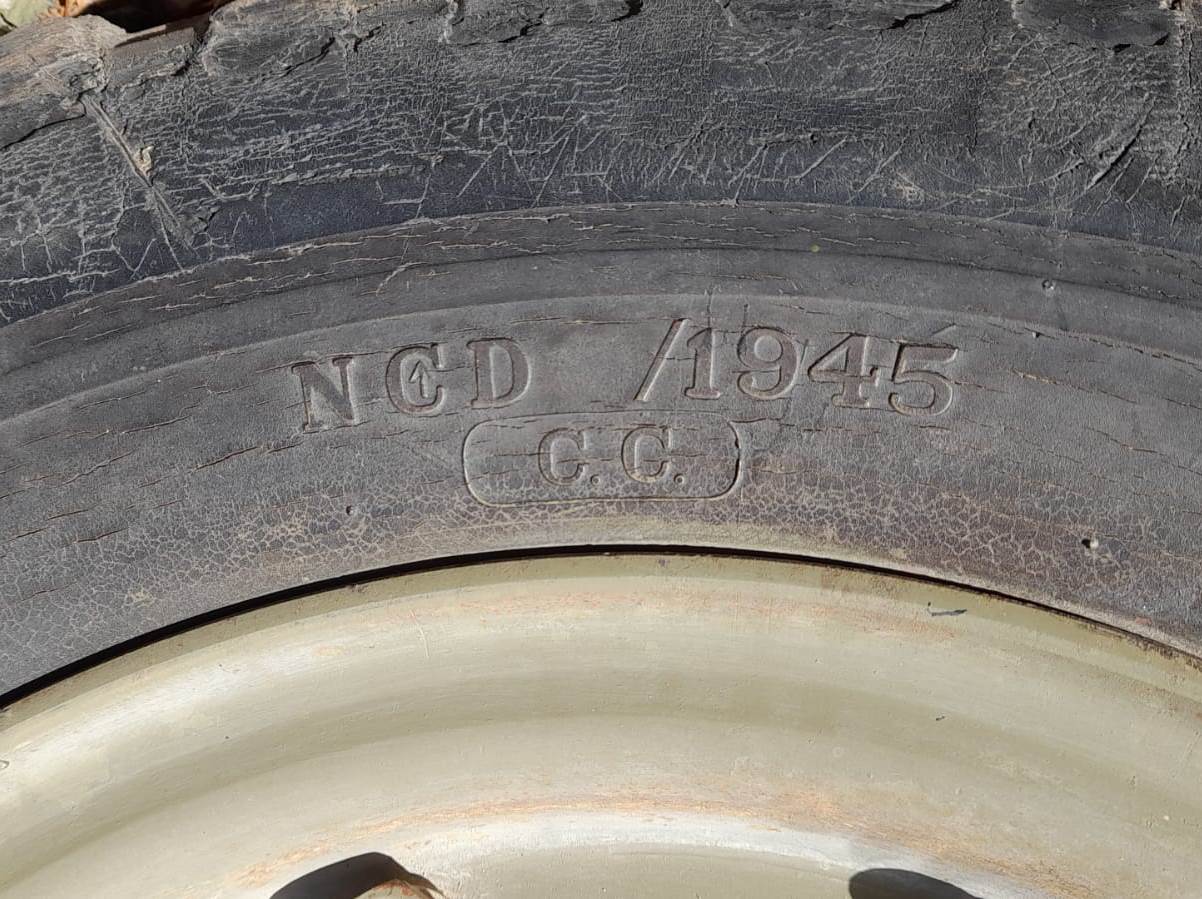

Goodyear 10.50-20, dated 1/1941.
"N C /|\ D" denotes Canadian Department of National Defence, so these tyres were manufactured on a Canadian government contract.

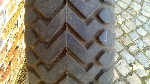

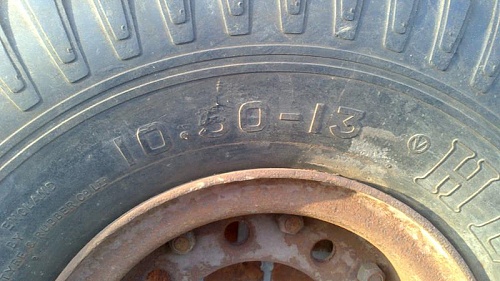

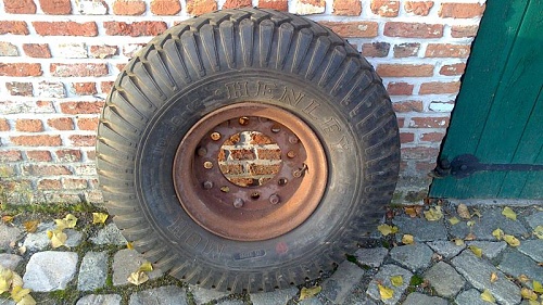

Hi Hanno:

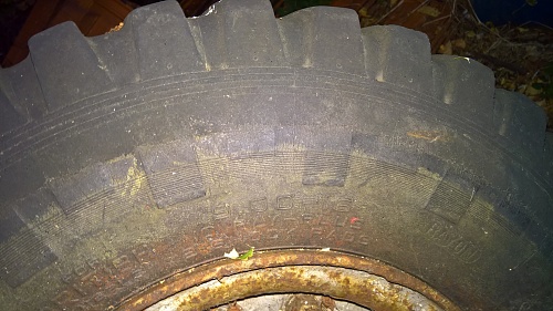

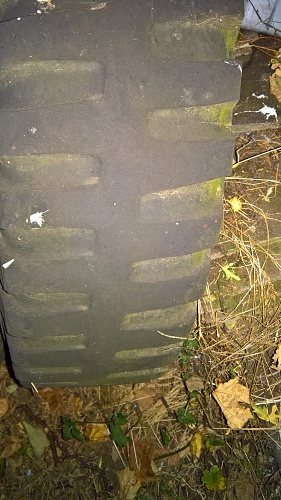

this tire I found in Brussels, he came from the airport Zaventem the farmer told me
I have other suppliers of tire brands here.
I'm going to take pictures of it and try to post here, I still have not found a solution to reduce the photos.
Hanno,
Henleys were an old tyre maker going back to the solid tyre era, based in Gravesend. Around 1957 they were bought out by Avon Tyres.

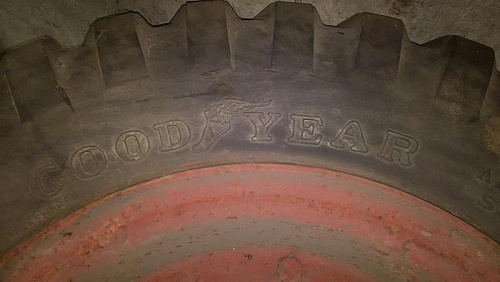

here a few tires manufacturers who are here at home with me.
20181019_175237.jpg   20181019_175006.jpg   20181019_174802.jpg   20181021_160603.jpg   20181004_140012.jpg

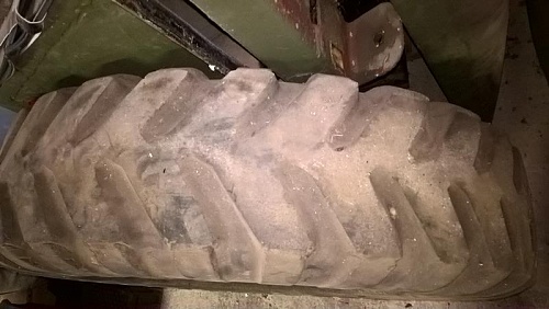

My Ford gun tractor still has original tyres , altough in a poor state , marked W D 10.50-20 MICHELIN , made in Great Britain
Philip Penny

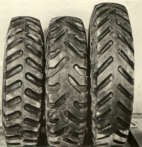

Recently, the subject of Michelin 9.00-16 tyres came up again. There is this well known photo of a 4.5" Howitzer in Singapore which has the same tread pattern as those tyres found by Mike on a Fordson WOT2D in Australia:
From a short internet search I learned that the Michelin Tyre Company Limited in London was incorporated in 1905 and that they were making a contribution to the Allied war effort, as they say:
Marking Time in Wartime
When the Second World War arrived, it proved a traumatic time for Michelin. Up till now the UK company had relied on day-to-day contact with Clermont-Ferrand, on whom it depended almost totally for functions such as research, design and testing. The invasion of France put paid to that – indeed, Michelin UK was carefully watched as its French parent was under German control and it quickly had to become self-sufficient in those disciplines that had previously been handed down from Clermont-Ferrand. Just to make matters worse, when the Japanese came into the war, they invaded large parts of the Far East, including the valuable rubber plantations such as Michelin’s in Indonesia.
Despite these setbacks, Michelin performed heroically, working three shifts a day, seven days a week and made an enormous contribution to the war effort. Of course, there was little time or resources to devote to tyres, but the years of marking time came to an end when the war finished.
They continued to make tyres for military applications after WW2 with the same type of tread, e.g. for motorcycles: https://www.wdnorton.nl/Tyres.htm
Name:  Michelin UK 4.jpg
Interestingly, the same tyre pattern was used for post-war production of 9.00-16 tyres, some of which were recently spotted on Dodge D15 trucks. If I recall correctly, they are 1970s dated and manufactured by Michelin in France:
ID:	123214 Click image for larger version

Dunlop Track Grip 1050x20 12 Ply dated 1945 Made in Canada
WhatsApp Image 2021-06-30 at 10.06.08.jpeg   WhatsApp Image 2021-06-30 at 10.12.37.jpeg   WhatsApp Image 2021-11-20 at 13.03.49.jpeg   WhatsApp Image 2021-11-20 at 13.05.32.jpeg   WhatsApp Image 2021-11-20 at 13.05.16.jpeg

More pics and inscriptions details
WhatsApp Image 2021-11-20 at 13.04.04.jpeg   WhatsApp Image 2021-11-20 at 13.04.18.jpeg   WhatsApp Image 2021-11-20 at 13.04.33.jpeg   WhatsApp Image 2021-11-20 at 13.04.48.jpeg   WhatsApp Image 2021-11-20 at 13.05.00.jpeg

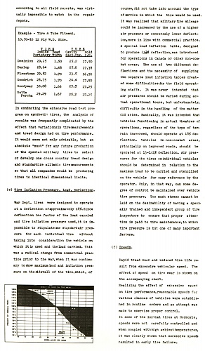

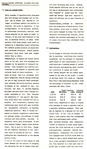

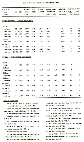

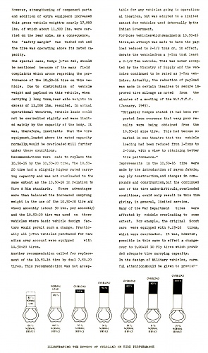

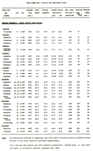

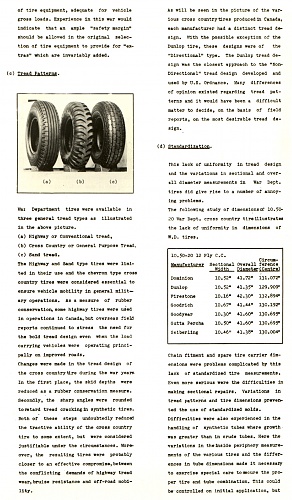

AEDB Volume 4
ID:	126054 Click image for larger version
ID:	126055 Click image for larger version
ID:	126056 Click image for larger version
Mariano Paz
Buenos Aires, ARGENTINA
1944 Ariel W/NG
1945 FGT FAT
Old 22-11-21, 14:23
m606paz m606paz is offline
Mariano Paz
Join Date: Jun 2009
Posts: 823

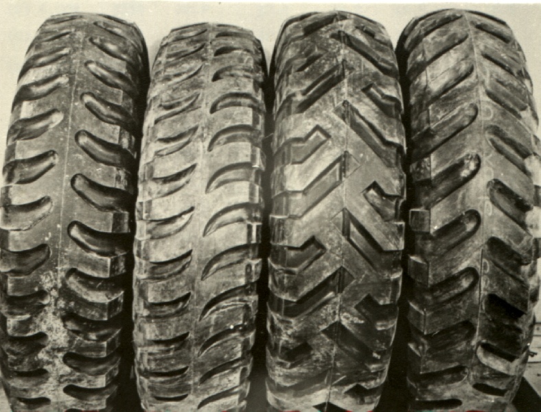

More AEDB pages
ID:	126058 Click image for larger version

Old 22-11-21, 14:43
Posts: 567
Thanks for posting that Mariano.
It is interesting the amount that the different makes have different dimensions for the same size tyre.
Old 22-11-21, 17:33
Mariano Paz
Join Date: Jun 2009
Posts: 823
More pages
ID:	126066 Click image for larger version
ID:	126067 Click image for larger version
ID:	126068 Click image for larger version
