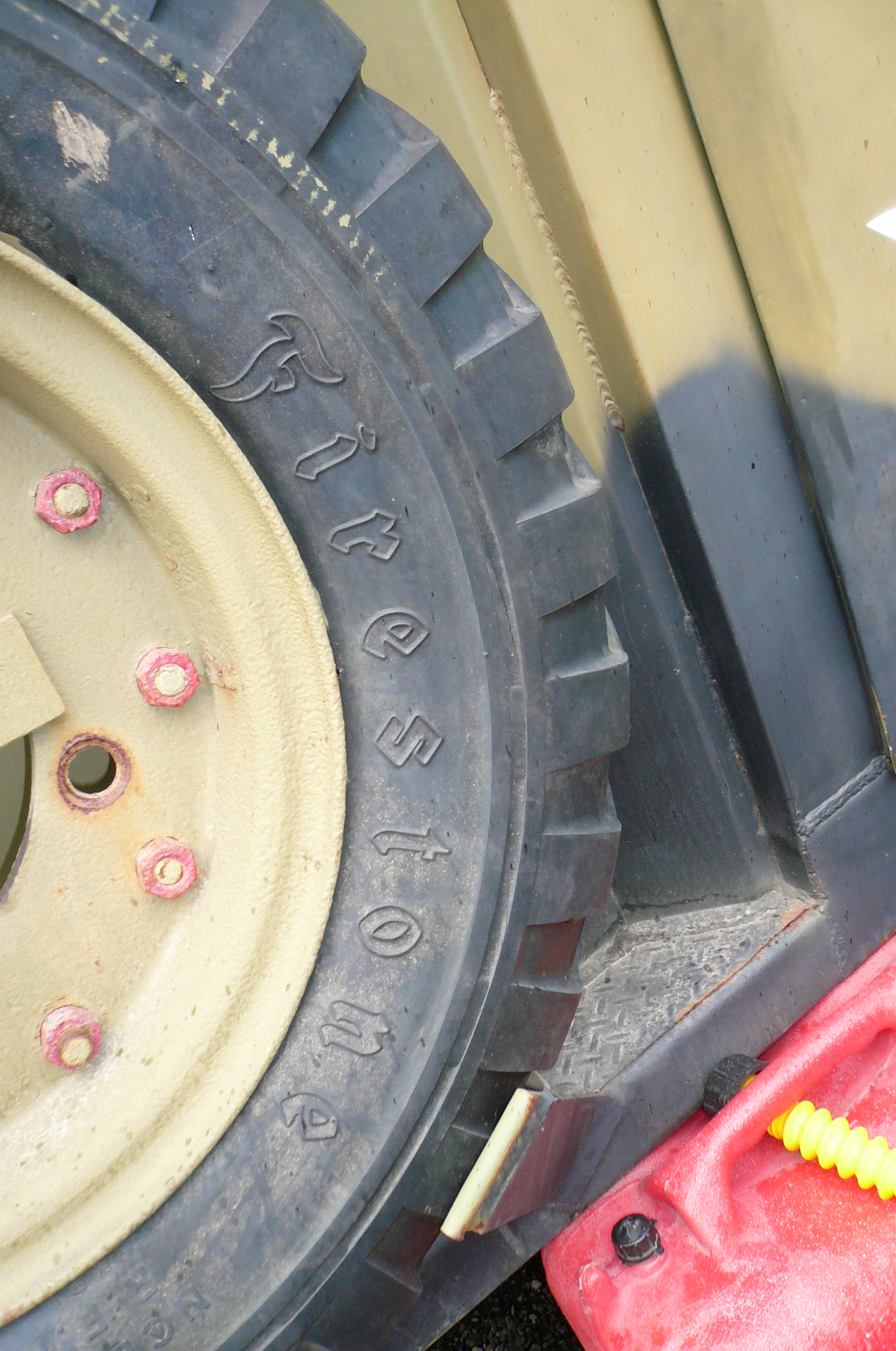

Over on "the other site", Mark Arnott asked me: "What was the original tyre manufacturer for CMPs?"
I know of one brand at least - see my pictures of a wartime Firestone Cross Country Ground Grip 9.25-16 tyre on a C8A HUP.
Who can add to this subject?

I think the obvious answer is that there is no such thing as "the original" tyre manufacturer for CMP's. Both Chevrolet and Ford factory pictures show a varierty of tyre threads and brands. The Good year (Chevron thread, Sure grip) and Firestone ground grip seem plentiful, but you also see the Dunlop Track grip tyres, and also road and sand tyres made by Dunlop, Firestone, Good year and India.
Even when looking at rows of finished vehicles at the Ford and Chev plant, you'll note a variety of tyres in a line of the same type of CMP.

I agree that there wasn't a single "original" tire manufacturer for CMPs.
In comparing actual properties (as opposed to nominal sizes) the AEDB record mentions Goodrich, Gutta Percha, Seiberling, Dominion, Dunlop, Goodyear and Firestone as manufacturers.
Runflats seem to have been mostly made by Goodyear in the common CMP sizes with a few in "odd" sizes by Firestone and Dunlop".
Most sizes of regular pneumatic tires, both cross country and highway tread patterns, had multiple manufacturers.

Despite these setbacks, Michelin performed heroically, working three shifts a day, seven days a week and made an enormous contribution to the war effort. Of course, there was little time or resources to devote to tyres, but the years of marking time came to an end when the war finished.
They continued to make tyres for military applications after WW2 with the same type of tread, e.g. for motorcycles: https://www.wdnorton.nl/Tyres.htm
Name:  Michelin UK 4.jpg
Interestingly, the same tyre pattern was used for post-war production of 9.00-16 tyres, some of which were recently spotted on Dodge D15 trucks. If I recall correctly, they are 1970s dated and manufactured by Michelin in France:
ID:	123214 Click image for larger version
