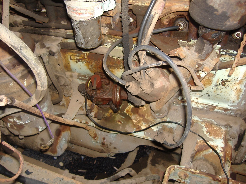

This old truck sucks you in, today I was converting it back to left hand drive, which is as easy as I thought it would be except for the usual mixture of Whitworth bolts, UNC bolts, and of course the mix of Whitworth bolts with UNC nuts and vice versa.
Anyway I thought I should see if it turns over on the starter, so a chucked a 12 volt battery in even though it is still a 24V starter. There are pitfalls with that as 24V starters will burn out on low voltage, but I didn't want it spinning over too fast until I check the oil and filters in the engine and transmission.
So after a good read of the wiring diagram and how to start a M216, as shown on Steel Soldiers forum, I pushed the lever and eventually she gave a little turn over.
Todays photos are not of a DND, CMP, or SMP Vehicle but the remains of a Ex US Navy M211 W/Winch cab, this cab with fenders and grille came as part of the deal with the M216.
The M211 cab is half way through a horrible attempt to convert to right hand drive, but it will provide seat mounts which haven't been converted, a right window winder, a left door latch, the correct UNF dash bolts and the passenger dash grab handle. All the M211 gauges have been smashed but the gauges in the M216 all look good. I am going to give them a clean with window cleaner as soon as I can.
The hood for the M211 went to the scrap man, as the fellow who threw it on the truck, told me the people doing the clean up at the yard had a discussion about what it might fit before they threw it on the load.
Interior from right side
USN Registration #
Front view showing some of the bits that are modified.

Some photos of the engine bay, or what remains of it. There is enough bits to make it possible to getting it going.
I pulled the distributor out and was prepared for it to be some exotic Chevrolet, General Motors rare as hens teeth item. When I checked the numbers on google I found it was a good old 1948-215 to 1956 FJ General Motors Holden grey motor distributor. While they are not plentiful anymore there are a few on ebay and condenser and points are available. The same distributor with a different suffix was used up until 1963 by Holden.

The plan is to set up two 12 volt car batteries in the right hand battery box for the starter and set up one 12 volt battery in the left hand battery box for the ignition. All this is very temporary just to get it going, if it starts and runs then I will look at doing something more permanent.

I believe that the original distributor has been replaced by a "will fit" unit. Originally, the whole M133, M135, M207, M211, M215, M216 M220 etc. series were fitted with waterproof electrical systems in line with the thinking of the period that MVs should be able to be driven submerged. In these systems the coil and distributor were in a single unit with waterproof enclosure. Similarly the spark plug wires had screw down connectors at each end with gaskets to keep out the water. All very nice while it worked but awkward and expensive for people using the trucks after purchase from the government so often replaced with the equivalent parts off a similar civilian motor (and a pain for restorers who seek original). Bottom line, the system on your truck isn't original but will make it easier for you to maintain in the short run.
It also looks as if the sealed voltage regulator has been removed, perhaps for similar reasons. Maybe more of the electrical system too. If they did gut the electrics, they may have substituted 12 volt civil equivalents which might make the original 24 volt gauges read wonky.
Old 06-11-18, 20:43
The installation of a civilian distributor is quite common on all the M-series vehicles such as the Dodge, the Jeeps, and the 2-1/2 ton. Not so much for the points or rotors, which are relatively common, but more-so for things like the 24 volt internal coils, the military distributor caps, and those expensive shielded spark plugs. Remember that before the days of the internet, you did not simply hit a buy it now button and your obscure parts were there a few days later....you had to send letters, or stay up until 2 in the morning to call some foreign country.
Easy enough to make right, once you find out if the motor is still good. There is plenty of the M135 stuff around...nobody really wants it anymore.

Grant and rob, the electrics are a mess, but I am not to worried, I am reasonably confident I can do my temporary work around successfully.
