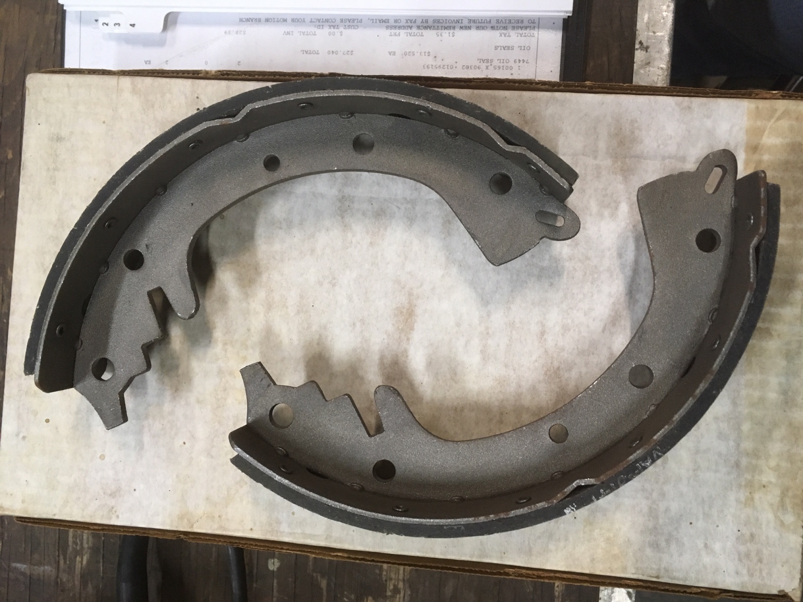

They should be 9" x 1-3/4. There is the possibility that you can have the older brakes from the 52/53 series of Jeeps, which had anchor pins on the bottom, but most likely you will have the same shoes Jeep used for over a decade. NAPA has them under part number TS40.

The shoes Rob refers to should look like this...
The sets also go by NSN 2530-00-307-8860. Same shoes front and rear.

Thanks Rob and Wayne for the pics....Rob....thanks for the Napa part number....off to do some ordering & shopping.
