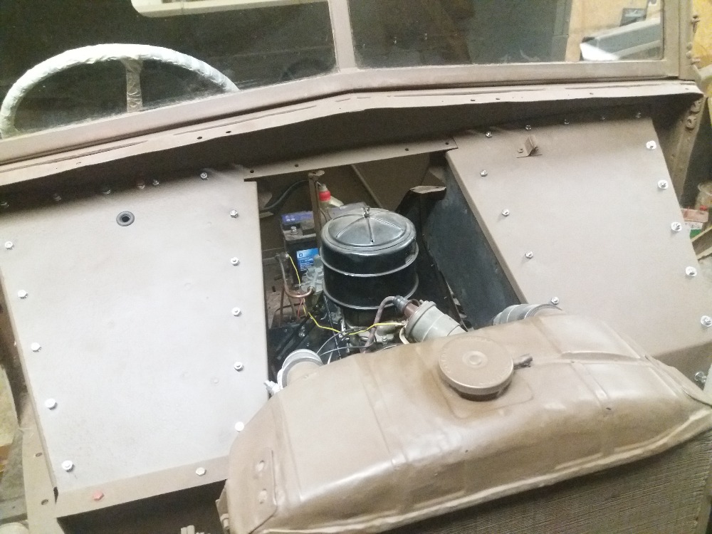

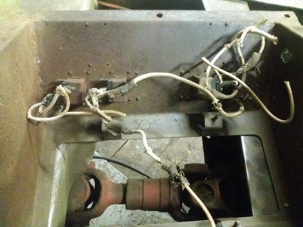

I made some more job on my FORD F15A CAB12, I managed to restore and place early dash but now I am helpless with the wiring in engine compartment. I already asked here about this and I thank you for all the comments but it all related to CAB11. I have CAB12 which I expect is different. Please if somebody have Ford CAB12 or you know anybody who has it send me some pictures or contact info. Can't go on without this.
Thanks.
Zdenek
20181201_231535.jpg   20181202_012554.jpg   20181202_013021.jpg   20181202_014509.jpg
Old 05-12-18, 17:34
ahleeds's Avatar
ahleeds ahleeds is offline
Join Date: May 2010
Location: moosomin sask.
Posts: 134
Default Cab 12 ford
this was my truck before I wrapped up the wiring harness.
There is a few more pictures on my F8 thread
Anthony
1954 GMC 211 , Restored
1941 F8, Restored
1942 F15A , needs box and restore
1944 C15A , needs box and restore
Old 14-12-18, 10:30
Zdenek Svestka Zdenek Svestka is offline
Join Date: Oct 2017
Location: Czech republic
Posts: 13
Thank you very much for help and for the picture. Do you know by chance where the ignition coil is placed and which way the cables to generator are lead?
