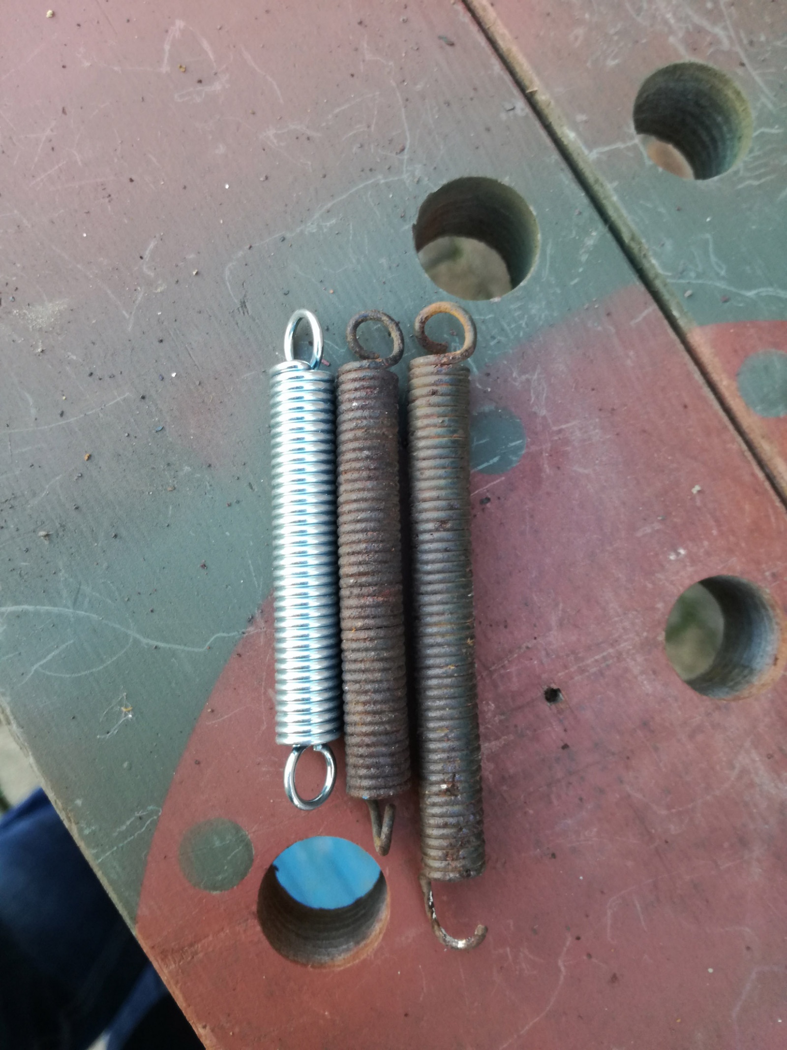

Here are the measurements of the spring on my C8 1940 front seats.
Rings (9 per seat)
Wire thickness 3mm
Overall diameter 25mm
Centre springs (18 per seat)
wire thickness 1,5mm
40 coils
Outside diameter 9,5mm
about 85mm overall length including the hooks
top and lower springs (6 per seat)
48 coils
about 94mm overall length including the hooks
The top 3 springs and lower 3 springs are longer than the ones in the centre.
Rings seem to be welded at the end....it's not solder as I heated one and nothing melted....except the skin of my finger
My seats don't have the springs as shown in Peter's picture (with one long hook)....maybe a difference in supplier at the time?? or Ford vs Chev? early vs late?

Attached are the rings and springs Hanno and I bought for our seats. Credits go to the Dutch Morris owner that found the suitable springs, as mentioned earlier in this thread.
Both springs and rings are Metric measurements, but they are pretty much spot on when compared to the originals, especially when you take production tolerances of the time into consideration.
I decided to use 1 type/length of spring, in stead of the 2, or sometimes 3, different lenghts used in the originals. I just stretched some of the springs to match the longer ones.....just put a screw driver in the vice; put one spring eye over the screwdriver, and use a second screwdriver through the other eye...than slowly pull and check against the original springs.
