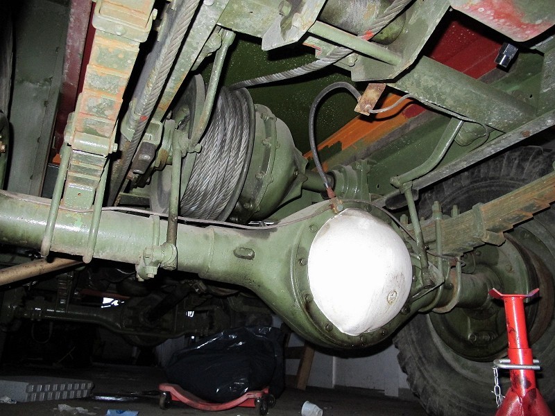

Can anyone explain some of this to me?
or give me more photos.
There appears to be a flat plate between the frame rails at the very rear?
Does it span rail to rail?
is it mounted below the rails (to the bottom of the frame rails?
Just how much area does it cover and what is it for?
Also...there are two cable reels...
what are these for?
And are they mounted below that plate I mentioned above?
is that the purpose of the flat plate? (a mounting surface?)
I'm guessing the two reels, create a guide for the tow cable...but I am guessing.
I assume these reels are not driven.
But are they brakes of some sort?
What about the diameter of these reels?
These are the only photos I have, and things aren't clear to me.

Dave, assuming that the winch fairleads are same across the range of CMP's:
The two wire rope sheaves or pulleys are un-braked and measure in at 8 3/4inch diameter, 1 1/2inch thick, mounted on a vertical pin that passes through a boss top and bottom of both sheaves. This gives an overall height of 3 3/4 inches between the two mounting plates. The top mounting plate is as you have marked, going full width under the chassis rail. There is a lower plate that retains the mounting pins, it is the width of the two sheaves combined, and is basically a wide "U" section welded to the underside of the top plate.
The bottom roller I have goes full side to side, but guessing the diameter would be the same, 3 1/2 inch.
You know there is a set of fairleads on the front bumper as well?
Rich.
Rich.
My "pulleys" are 12" x 2" scale size...so not too far off.
Not bad for a guess.
Sometimes, a bit bigger is better for scale assembly.
I am still unclear about the second mounting plate.
The "wide U section" you refer to.
I can see part of it in my reference photos, but its still not clear to me
how it mounts, or its actual shape and size.
Its not a big concern, since I am not including every accurate detail, but...
"fairleads"...whats that?
You wouldn't be talking about that roller cable guide thingy?
Is that what you refer to "up front"?
Where is the cable guide in the rear?
Does it go here(photo)?
Something is missing (on my model) to guide the tow cable under the frame.
Old 29-04-19, 14:15
Posts: 1,237
Better described as a Wide "L" shaped plate...this also holds the guide roller behind the sheaves.
Fairleads = Roller Cable Thingy, or any roller guiding the winch cable.
The fairleads on the front, as shown in your pic, are nice and simple, they can be heavier and more complex than that: swing out rollers to pass the cable hook/eye through.
Just in case.... the wire rope is fed around the outer sheave and forward to the fairlead on the front bumper for when winching is required at the front of the truck.
Rich.

a bit late reply but this might give you an ideal how the winch cable runs.
photo credit to Hermann Van Hove
