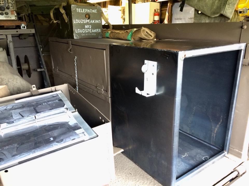

Posts: 4,192
Lots of progress today. I picked up the sheet metal from the shop today. They did all the heavy bending for me since I’m limited by the size of my break. I had made the end panels last week already. So today’s task was to do a fitting and then welding everything up. It’s looking more and more like the wartime photos.
8E5857B6-6298-43D3-8795-BC5AFD7F6E75.jpeg   BE24F321-470C-42ED-BD40-4EAEA2106864.jpeg   F0FC1A80-C56A-4752-A679-237199B8323D.jpeg   031E8C26-82BF-4644-B487-3CC3C0B4C698.jpeg   6AC8F321-7A5D-4DC6-9BD8-7A7F2CB1E520.jpeg

Lastly I got the radio battery trays installed. They are removable just like the radio table.
25DA8541-BAC1-4750-B133-D967C6D2C60B.jpeg   FAAF6D78-82C3-47A8-8D7B-85C46344D948.jpeg   80F6592F-88C1-4313-B0D1-F8E1B4EA1CCD.jpeg   832E4E0C-280D-4622-81C6-B84F974A7458.jpeg   D51FFE82-4F66-49C3-BEE4-DD0F2D212212.jpeg
