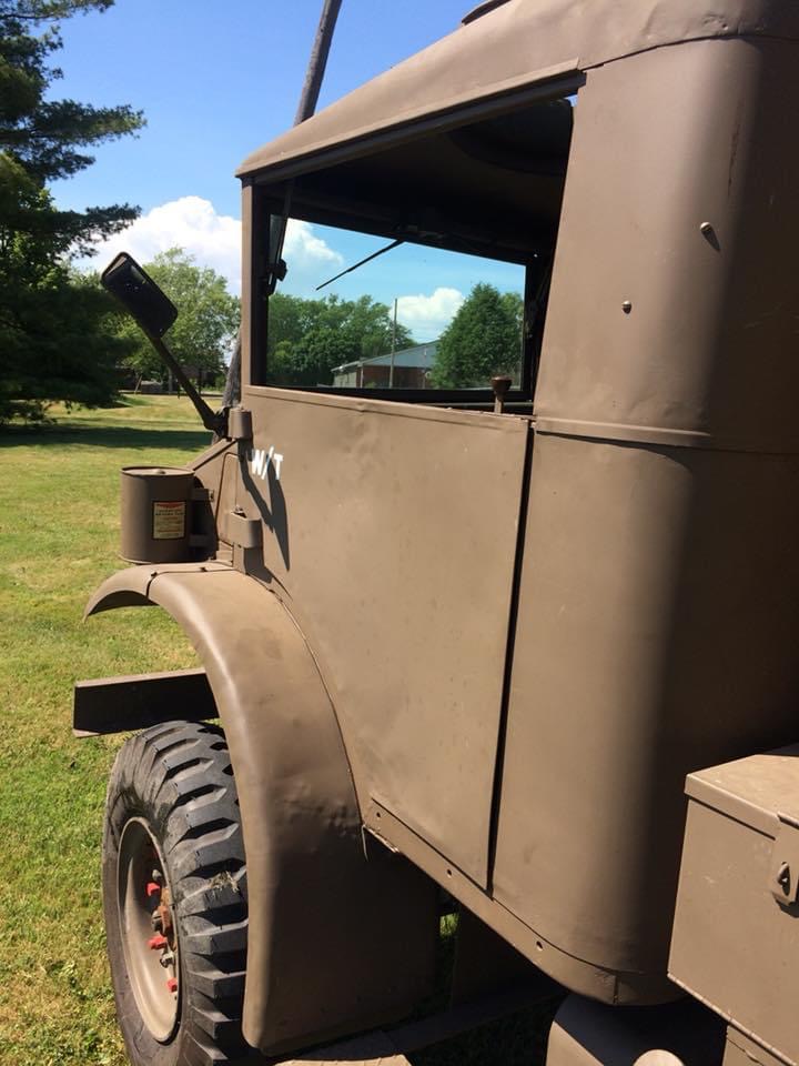

Took the truck out for some better pictures today.
29AB9D31-E9DB-418A-844A-FC4B0DB4C5E7.jpeg   5BF32DC5-7530-4E87-98A9-D61D3C948682.jpeg   FBEBD5A8-F2FA-4F3A-9AB2-4EBD60FBDAF2.jpeg   732B274F-7305-472B-914F-2C3760A6D18E.jpeg   D2A60671-0C2E-4E15-816D-EC54F46E10D3.jpeg
  #824
Old 21-06-20, 04:03
Posts: 4,184
The rest of today’s pictures.
A1A78EB9-8718-4D72-B778-A8AB436866B1.jpeg   13F33017-BA62-4A04-B1B2-BCA3681AE274.jpeg   EBD299F3-B6D2-46EF-BA89-44F6661F7ACB.jpeg
