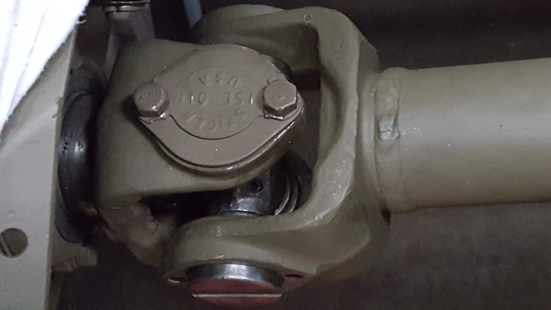

Amongst other projects this week, I’ve done a bit more tinkering with different things on the M8.
I started up the engine again a week or so ago. It hasn’t run for nearly two months but started up almost immediately. I think the fuel pump on it is working very well. It was the first time I had the engine running since I fitted the exhaust system on it and sitting in the driver seat, I wasn’t sure it was running initially as the engine was very quiet. Here is another video: https://youtu.be/b6F-Bt4FQ_4
I had left the drive shafts off so I did some testing with the clutch and the gearbox. The clutch is definitely working well and while initially I was able to move through some of the gears, I found I was getting some binding and changing back from reverse into neutral was very tight.
I isolated the problem to the remote linkages, not the transmission. I had fabricated the longer of the two shafts that run between the transmission and the transmission control housing. Although I had the length of the long rod correct, the mounting hole spacing for the universal joint was out by a few mm. After drilling some new holes I put it all back together again and the transmission now shifts smoothly. I used some fairly sturdy pipe for this rather than solid rod. It seems sturdy enough so will see how that goes.
I ran the engine again and shifted through all the gears. It does shift very smoothly but the hydraulic clutch will take some getting used to. It just has a completely different feel to what I’m used to. Reverse gear does sound rumbly but I guess that is the cut of the gears?
Since that testing, I’ve fitted all the driveshafts ready for my road test. I was missing the little cap/cover that locks the universal joint bearing caps in place. After a bit of searching, I found some at a local scrap dealers. Interestingly, these are the same size as the covers that go in the hull above the sponsons for access to the tubing and wiring that runs through the channels on the sides of the vehicle. I have a couple of spares if anyone needs these.
I picked up a couple of M8 wheels a while back so I had the old run flat tyres removed and the wheels blasted and painted. I will swap these out with the two Scout Car/Half track wheels I currently have on the M8.
I spoke to my brake guy today. He has been working on the wheel cylinders I sent him. In his testing, he couldn’t fault one of the cylinders (!!) but does believe that the other one is leaking between the sleeve and the cylinder. He is going to press this sleeve out and fit a new one. Hopefully that will fix that one. He agreed with you guys in the US that the kits with the full cup and new pistons (the GMC type kits) are the way to go, so my plan going forward is to fit these new kits to each cylinder, bleed the system and monitor each wheel cylinder. If the cylinder develops a leak, I’ll send it back to the brake guy so he can redo the sleeve. It’s a lot of work, but I can’t see another way to progress things and it should all be for the best with the new pistons. That’s the plan, anyway….
A couple of other jobs I’ve been working on are a bridge weight sign and the turret ring indexing. Anthony from Axeholme Signs came to the party again and supplied me with a paint mask for the bridge weight sign and decals for the turret ring markings. The turret ring markings take some time to do but they do give a very nice result. Having the covers out of the vehicle is the way to do it. I'd say it would be a bit awkward doing it with them fitted around the turret.
That is all for this week…

Hi all,
I’ve been reminded by a couple of people that it has been some time since my last update. I’d been out of action after having an operation on my foot and having crutches and then a moon boot is not conducive to getting in and out of an M8. I can now get a shoe on my dodgy foot so I got back to work on the M8 in the last couple of weeks.
My last update was around the gear stick and the brakes. I fitted the other gear stick I had to the housing. I also raised the height of the housing a little bit as the rods were fouling a bit on the circular cut-outs in the intermediate floor. The height increase has worked. I also checked the front axle declutch system on the transfer case. That is working correctly so I am back now to experimenting with the rods to the levers. I don’t think I have the lengths of these right yet. The gear stick has quite a different angle to the other one and I think this will give me some more leg room.
After rebuilding all the wheel cylinders using those English and Spanish cups I can report that these are still working well. I’m not sure why the other ones leaked and my brake guy can’t figure it out either as the other ones were good quality. Touch wood, there are no leaks.
However, I was, and still am, having problems with a soft pedal since I changed to the Raybestos cups and pistons. I also found that the piston in the master cylinder was quite slow to return so I figured it was a good chance to strip the master cylinder and satisfy myself that all was well in there. I couldn’t find anything wrong in the master cylinder and so I reassembled it with some new rubber grease on the cups. One thing I did do when fitting the master cylinder to the hull bracket was to cut a slot in each of the mounting bolts. I’ve found that the two top bolts on the master cylinder are so close to the body of the master cylinder that you can’t get a socket or a spanner on them if you have to remove them from the mount. When I next have to remove the master cylinder, I can use a long screwdriver to remove those two top bolts.
While I had the brake master cylinder out I thought I might as well check the clutch master cylinder as well. I had noticed the odd drop of fluid at the back of this cylinder. It wasn’t such that it was leaving a pool of fluid on the floor, but just the odd drop near the top of the foot pedal. I stripped this and checked everything. Again, all looked good. I spoke to my brake guy who put the stainless steel sleeve in this for me and he was reluctant for me to change that donut cup on the end of the piston. As he said, it had done nothing and was new. I decided to reassemble it with some new rubber grease on the cups and set it up on the bench for a few hours and pressurised it with the pressure bleeder. The area at the back of the piston appeared just slightly wet but no drips developed so I decided to put it back in the vehicle and try it. I bled the master cylinder in situ and then connected everything up and pressure bled the system again. That all worked well and the clutch is fine again. There are no signs of any drips from the master cylinder yet. Touch wood again…
Back to the brakes and the soft pedal. Despite all sorts of attempts at bleeding the system with a pressure bleeder, the pedal is what I’d call ‘soft’ and gradually goes to the floor when it is depressed. The master cylinder is working fine. I removed the line to it, bled it in situ and connected a short line with a plugged end to the outlet. This gave me a hard pedal so I knew the master cylinder is working and the primary cup is doing its job. I've actually found that fitting the two master cylinders here and bleeding them in situ (rather than on a bench) does work quite well. You can easily manipulate the foot pedals and both master cylinders are right in front of you which makes bleeding them nice and easy.
In the meantime, I wasn’t happy with the right rear wheel as I had fluid seeping from the connections between the slave cylinders and the brake Tee at the top. The Tee and lines were both tidy but used and the tube nuts were not the greatest, so I wanted to replace both lines and the Tee connection. Some NOS parts that I had ordered arrived including some new brake lines, so I thought I’d fit those before going any further. Unfortunately the lines that arrived were all the longer ones for the left side of the vehicle, so I couldn’t use them, and had to clean up another couple of lines that I had here that had good tube nuts on them.
I now have a few of these NOS brake lines spare if anyone is looking for any!
While I was working on that rear wheel one of the guys from Action Engineering next door came through and knowing I had been having problems with the brakes asked why I wasn’t using a good vacuum pump to bleed the brakes. He returned with a fancy Snap On brand vacuum pump that runs off compressed air. I thought it was a good chance to use this system so I ran it over the entire braking system, bleeding at each nipple. As I’ve found in the past though, the difficulty with these vacuum pumps is that they seem to suck air in around the bleeder nipple , and despite applying some silicon grease around the bleeder nipples, you are never sure if the air that you see in the plastic tube is coming from the braking system or being sucked in around the bleeder nipple.
This bleeding had no effect on the brake pedal so then I tried isolating the various parts of the braking system. Using three sets of vise grips and some cardboard to protect the hoses, I clamped each of the rubber hoses that supply fluid to each axle. Viola! A very firm brake pedal. I then moved the vise grips to the far end of each hose to each axle. There was no change meaning the brake hoses were not expanding at all. This has proven to me that the problem is in the wheel cylinders.
What I had recently read about the difficulties in bleeding a system with these vertical wheel cylinders is now coming to fruition! There is obviously air getting trapped under the top cup in each wheel cylinder and no amount of pressure or vacuum bleeding wants to dislodge it.
I am still working on a solution but if anyone has come up with a novel way to get the last bit of air out of the wheel cylinders, I am all ears!
Damn brakes!
That is all...
20201102_101515.jpg   20201102_110620.jpg   20201029_164924.jpg   20201102_091807.jpg   20201104_091458.jpg

More photos.
20201104_092336.jpg   20201104_110146.jpg   20201104_114033.jpg   20201104_125831.jpg
