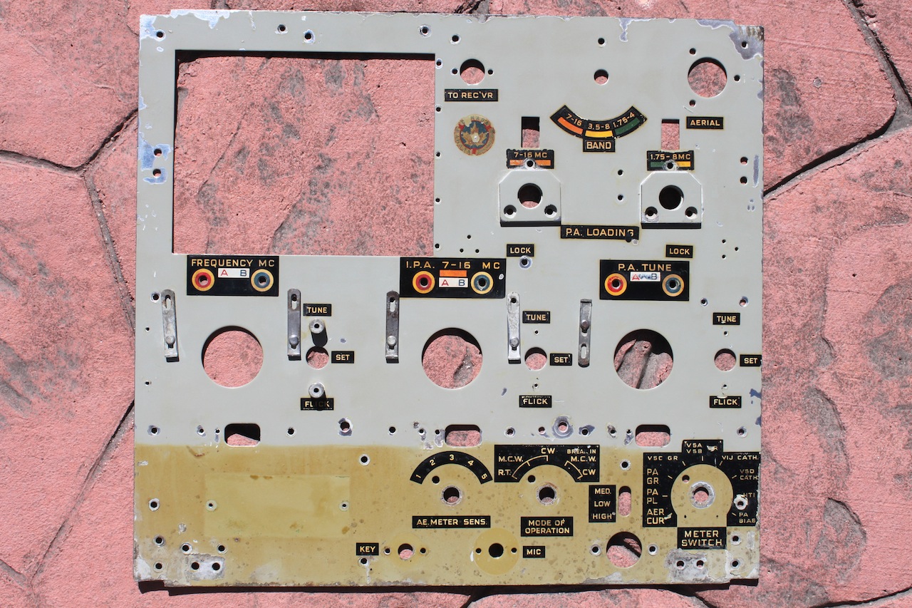

I was able to even out the cleaning a bit today, and with this little bit done with, a quick calculation gives me about 59.65 % of the panel cleaning for the Sender has now been completed.
That finally includes the five riveted STOPS for the three dials, which are a real pain to clean around effectively, and it also gets the upper riveted mounting post for the clear acrylic POINTER located on the right side of the FREQUENCY dial. Just the lower riveted mounting post to deal with now and after that, nice flat panel to work on.
This point in the cleaning also leaves 14 of the 30 decals now cleaned around, so nearly half way through that part of the task as well.
I am going to have to get another tube of polish this weekend. The thick coat of varnish on this Sender panel is really eating through the tube I purchased at the start of this project. By comparison, when I cleaned about 10 19-Set panels back in the 1980's, I still had nearly a third of a tube left.

I admire your patience and attention to detail David! Great work. Do you plan to reapply some type of clear coat in the end, or leave it as-is with the polished surface?

Cloudy with showers this morning in the ‘Peg, so no polishing getting done today. I do have a few errands to take care of, however, one of which is picking up another tube of polish to see me through the rest of this project. I will probably also get a chance to do some work on the new CPP-2 a little sooner than I expected.
Thank you for your kind words, Wayne. Very much appreciated. Once all the discoloured varnish has been polished back, I will be leaving the front panel alone, other than the required touching up of missing paint. I know there are a number of modern clear coats available for protecting and relaxing the decals available for modeling etc., and they work very well. The big unknown for me, however, is I have no clue what these 75+ year old water transfer decals are made of, as compared to today’s products. I am just not prepared to risk them. It will be a different matter when I get to the Supply Unit restoration. I will be taking it right back to the metal and essentially starting over because the 1966 rebuild decals are the wrong colour, font size and poorly applied. This is in addition to the lower inch of the panel having been bent inwards just enough to pop the paint off along that section, which puts the quality of the rebuild priming into question. Since those decals will be modern materials, I will use a modern flattener/top coat on them.
I am a bit of an odd duck when it comes to this restoration I fear. Whenever I am looking at this wireless set, or handling it for that matter, I cannot help to wonder about all the hands it passed through at the Canadian Marconi Company plant in Montreal. From the people punching out all the raw metal parts, shaping, welding, riveting, painting and all the many assembly points until it was tested and packed for shipping.
Probably mostly women with some older men sprinkled into the mix, but all brought together to build something as their contribution towards the war effort. Did they ever wonder who would end up using these sets they were making? Would a particular set they were working on be one to handle special, or important communications? My mind just doesn’t stop with this really. The decals on this Sender really get to me sometimes. They are the originals. Somebody was actually handling and looking at them the moment they were applied. Checking everything was just right and moving the panel on to the next station. And now, here I am doing exactly the same thing. In their wildest dreams, I am sure none of the CMC workers who moved this particular wireless set down the assembly line ever dreamed that in 2020 it would still be around.
I cannot wait to finally get this set up and running on the air again. I really want to hear what it sounds like. Warts and all. We read all the time about the problems and limitations of wartime signals equipment. Just another factor that impresses the hell out me regarding the determination of the wartime generation. They worked through all of that and got the job done! So if reading about what they achieved is impressive, I most certainly want to experience the same conditions of operation of this equipment as they experienced. That enables me to more fully appreciate their accomplishments. For me, that experience is an important link to our past generations and would be completely lost if I were to gussy this set up with all sorts of modern improvements that turned it into a ‘much better set’. If I want a much better set, I can buy one at any of a dozen shops in town. But I will miss the experience.

Another bright sunny morning so another good polishing day.
The last little fiddly bit has now been cleaned around so pretty much straight forward polishing around decals remaining.
At some point in the history of this Sender, somebody grabbed the central HANDLES of the I.P.A. 7-16 MC Dial, with the palm of the hand pressed hard against the dial plate and gave it a hard turn. The result was the Stop Pin on the back side of the innermost Tuning Plate was dug into the panel paint, leaving a noticable semicircle gouge in the paint. this was hidden until the disassembly process, but can be seen in any of the earlier Sender panel photos in this thread.I was able to successfully polish out about 75% of that gouge.

The color difference between the clean/unclean section is amazing! Keep it up. Like I’ve told you before, I enjoy following this restoration.

Beautiful and sunny this morning so another bit of polishing has been accomplished. Nice to be this close to the finish of this portion of the project. Just over 75% done now and 21 of the decals are 'popping' like they used to on the panel.
My brain is telling me to get some more polishing done today since rain is supposed to return for the rest of the week. We shall see how that idea goes and if I get more done, I will update the progress later today.

I ended up taking advantage of the sunshine today and getting a bit more Sender panel polished. I can now finally say the polishing process has reached all four edges of the panel.

I was able to get one more section polished back this morning. Timed it well, as the overcast is just now starting to roll in for the day. I think two more good polishing mornings should do it for this piece of the project. Then I can concentrate on touch up paint needed for the panel.

Finally, after 18 days of polishing, the Sender panel of this 52-Set, once again has a consistent, close to original, coat of Gloss Navy Grey visible on it.
Only fitting I compare this to a photo of what I started out with on the first day of this task.
It got a little dicy in the last 45 minutes of todays session when the clouds started rolling in and out, but its done now.
Next step will be to pick up a can of grey oxide primer and get ready for the paint touch up work.

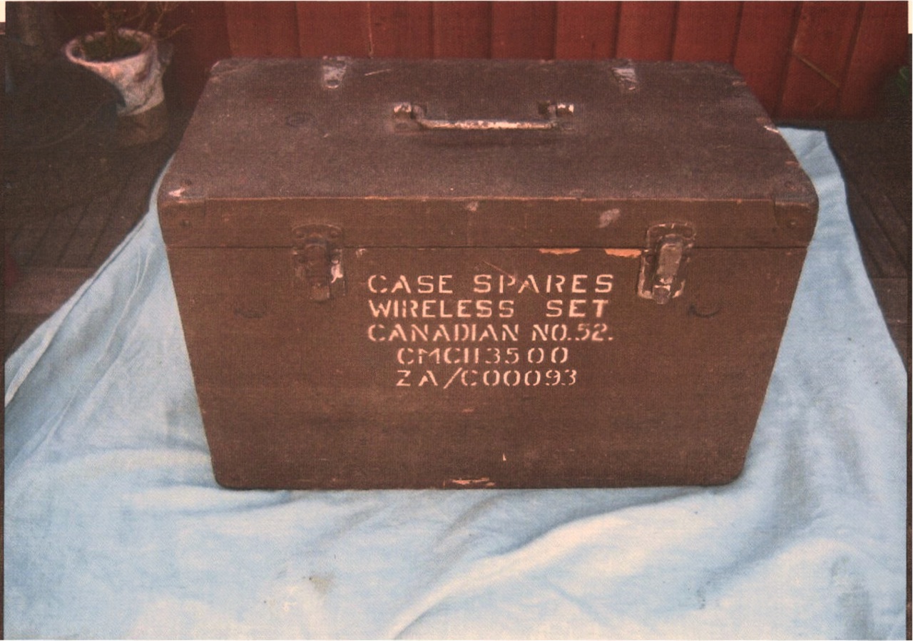

Default Case Spares Wireless Set Canadian No. 52
I received an email early this morning from Jordan Baker regarding a Case Spares for the 52-Set that had just turned up on the UK eBay site. I am not in need of one, having two already, but this one was interesting because of its nicely preserved stencil markings. These are completely gone on one of my boxes and the other has only fragments surviving.
Sadly, the KimPak Lining and interior partition have been removed from this box, but as noted, the ¾-inch high by ½-inch wide, 1/8-inch thick characters of the stencil are very nice to find and patterning a stencil from this photo should be relatively easy, down the road.
The other interesting feature is the C-Broad Arrow marks on this box. They are somewhat larger than I had expected, and in black. Good to know. The funny thing about these stamps on this particular box is the sheer number of them. Somebody must have been having a very boring day in the Acceptance Room when this box arrived. Note there are two partial stamps on the front of the box, outboard of the lower part of the latch. And then on the lid, there is another pair of complete stamps, roughly midway between the handle plates and the outer edge of the lid.
