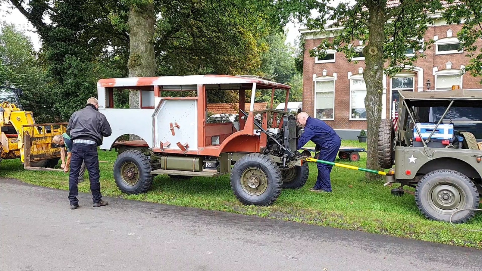

This weekend was showtime we mounted the Body and Frame after years of seperation.
What seemed to be an easy fix turned out to be a little more tricky than we thought, the handbrake lever was in the way and so was the shifter lever.
We had to dismount the handbrake and tilt the body over the shifter lever..glad we had the right equipment.
The tow to the location of the body was also memorable
I have added some pics , enjoy
ID:	124665 Click image for larger version
ID:	124667 Click image for larger version

  #113
Old 13-09-21, 15:59
Location: Clinton Ontario
Posts: 414
Default body on
Congratulations Pieter for mounting the body. Now the fun part of restoration starts , going ahead and seeing the vehicle become whole and complete.
Gord

Hi Pieter, congrats on the important milestone of the "marriage" of body and chassis.
I love the fact that it was done on the side of the road - just like the RCEME would have done!
