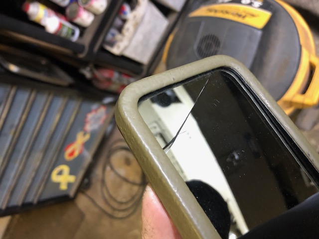

I sourced these replacement mirrors in the UK, they are Lucas type 160 mirrors and while they sell the chromed mirror assemblies reasonably I enquired as to replacement glass and indeed they had them. bought 6 to replace a couple of assemblies I had with broken mirrors and a couple of others are wearing out and loosing there reflective material with age.
I waited until i got them and installed them, they fit, they are nice and i recomend them. My correspondence and their contact information.

Am I reading the part number correctly as 094.138?

I woulkd use the reference to Lucas type 160 or even say, the same ones Harry moon bought.
buy extras. I threaded in a replacement screw that was just a hair too long.
