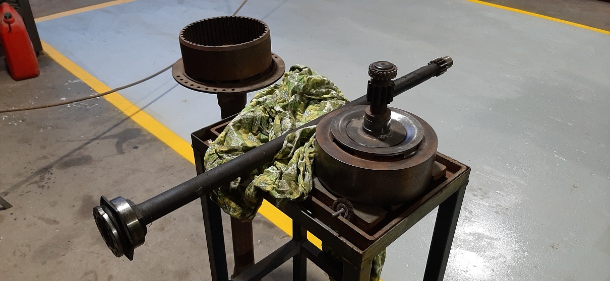

Hello one and all, it certainly has been a fair time between drinks. I had to side step the Vickers for a while as I had a couple of jobs for people I had to do but I have managed to find just a little bit of time to fit the traversing gearbox. It required a lot of climb in, check, clime out type of fitting but it is done and it works an absolute treat. I can't believe just how easy and smooth it turns with zero binding. I still need to remove it and get the die grinder in and clean it up a bit. I will spend a bit of time on the engine tomorrow for preparation of installation. I still have more external jobs to do so I will have to squeeze in the Vickers when ever I can. I do suffer from Vickers withdrawals if I leave it too long.
20190526_174156.jpg   20190528_135809.jpg   20190528_135819.jpg   20190528_140106.jpg   20190528_140122.jpg

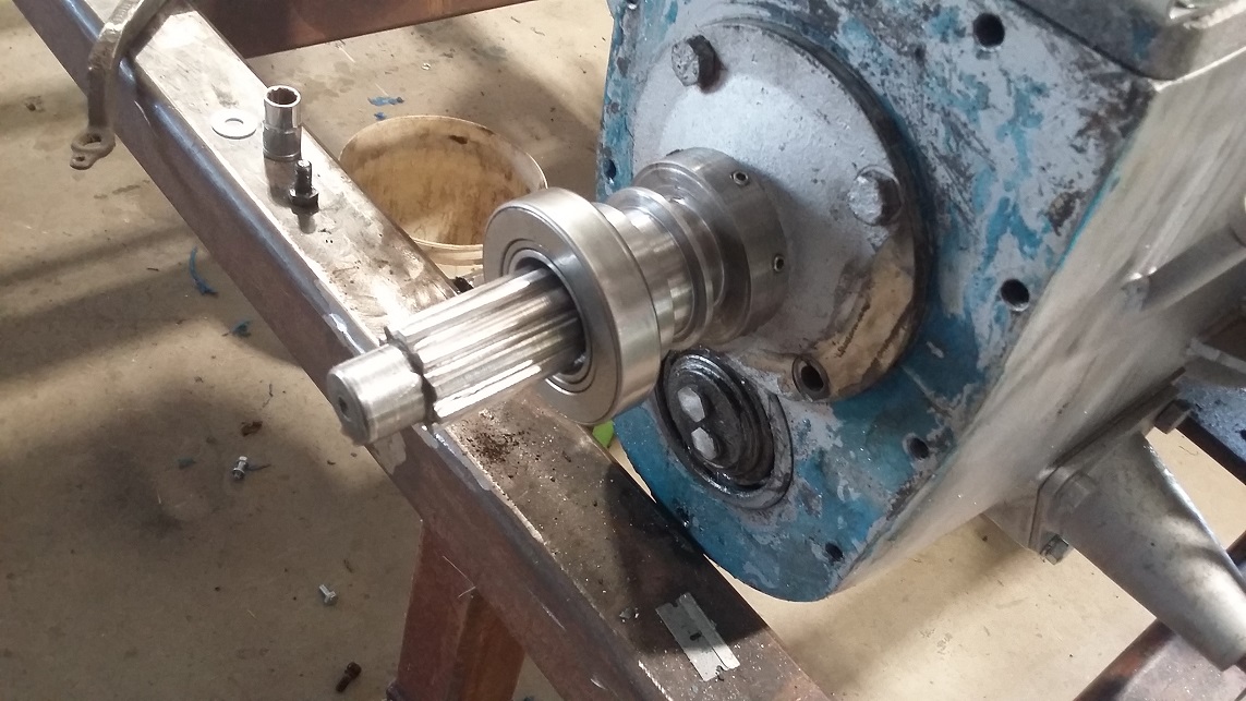

Anyway, I separated the trans from the engine and found that the thrust bearing was jammed against the back of the input shaft shoulder so it needs to be machined off about 8-10mm or so. I never realized that as I was putting it together. I just thought it was a nice tight fit. I need a new one now as I broke the old one as I was trying to press the old bearing off. Not a bad thing really as a new bearing should have been on the cards anyway.
20190529_122423.jpg   20190529_122429.jpg   20190529_122447.jpg   20190529_122454.jpg

I had to get another clutch as the other one I had was wrong. It required extensive modification.
20190624_113258.jpg   20190624_113442.jpg   20190624_114347.jpg   20190624_114601.jpg   20190624_115706.jpg

Nothing is simple when mismatching components and they just have to work.
20190624_115720.jpg   20190624_115733.jpg   20190624_142129.jpg   20190625_094601.jpg   20190625_094731.jpg

I had to get a new clutch, pressure plate, get the flywheel faced and drilled to suit the new pressure plate. Machine a surface on the bearing retainer plate on the front of the gear box. make a new thrust bearing holder and input shaft cover. Modify the old yoke to fit the new thrust bearing holder. It is now a complete new clutch system ready to be put together. There's a new road at every corner.

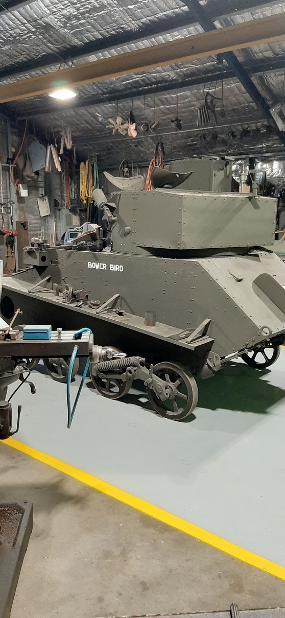

Hello everyone, as we are still sort of on lockdown and the job I still have is on hold I thought it is a good time to get back to the Vickers. I can't believe how fast time has gone. I had a workshop move around and tidy up and here is where I am at the moment. The engine and trans is in, exhaust made and fitted and I now need to concentrate on the final drives.
  #1094
Old 23-05-20, 13:12
colin jones's Avatar
Posts: 1,810
I'll try again after I resized the gallery.
20200523_163352.jpg   20200523_171808.jpg   20200523_171820.jpg   20200523_171841.jpg
  #1095
Old 23-05-20, 13:24
Posts: 1,810
OK so the problem was the photos were too big and for some reason it up ended them Anyway I will have to remember that. The Chev engine is in and it is a very, very close fit but that's OK as long as it is in. I custom made the exhaust and that too is fitted. I have to do some linkage and final drive completion which will take a while.
Chris, to answer your question about my CNC Plasma cutter. I am running a Hypertherm 85 and it does the job for me but is a far cry compared to a water jet.
