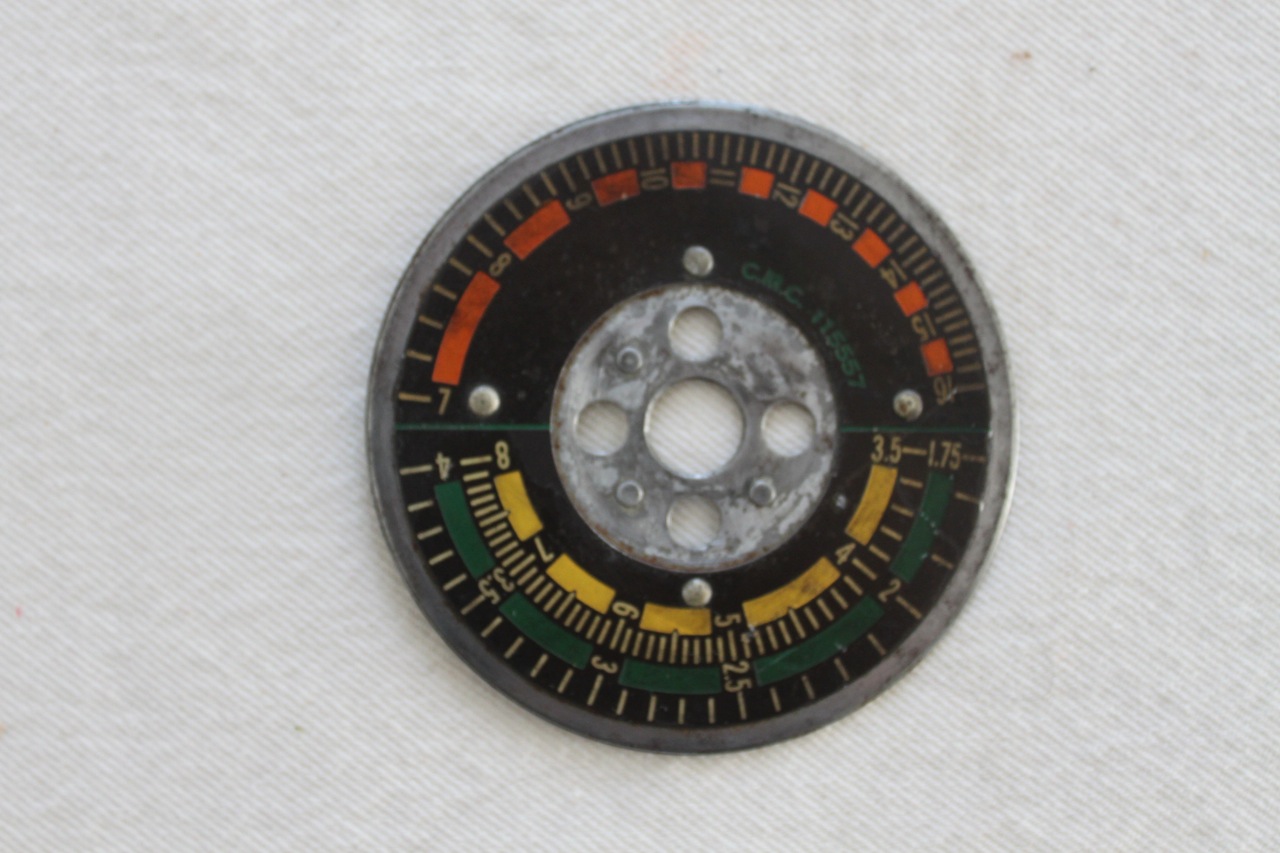

Default DIALS, Engraved CMC 115-477 ZA/CAN 4653
Just a bit of a way point in the continued direction of this project.
To recap this photo, the original dial to the Sender is the one on the left. All three dials look that bad. the one on the right is the one to be used on the Sender. It was off the Parts receiver.
The original dial is going to become a test bed of sorts. According to what I had read on electroplating, plating metal will not adhere to a cathode item at all if it is not meticulously clean. The existing adonized and painted dial has darkened somewhat over the years but is not that bad. the zinc plating around the rim and central dial plate is another matter. What I am curious about is what will happen if the rim and central metal are carefully cleaned back to good metal and I then electroplate the dial. In theory, no new metal should transfer to the painted section at all. Only the centre, back and rim of the dial, along with the four small rivet heads.
I am going to try it out and see what works and does not. It may be a useful restoration process for the other two remaining dials.
If you check back to Post #513, you will see the original of this dial from my Sender on the left hand side. I had decided to use the spare dial on the right, from my parts receiver, as it was in better overall condition.
I also wanted to try out a test electroplating with this original dial to see how it would work out. The results are in.
In the first two photos today, you can see the original dial after I had cleaned all the metal surfaces with a brass wire wheel on my Dremel Tool. Once the bare metal was cleaned of all rust and other crud, I cleaned the entire dial with a general purpose cleaner and then rinsed it with Isopropyl Alcohol. This was followed by a light coat of car polish, on the black engraved face of the dial, to hopefully further prevent any plating from happening anywhere on it. Then into the electroplating solution it went for just over two hours.
When it came out of the solution, I was very pleased with the even plating around the rim, and once it had dried for about 20 minutes the central hub and rear of the dial looked pretty good as well. As it continues to dry out over the next couple of days, I expect the colour of the plating with lighten some more.
A couple of interesting observations. First, deposits of zinc did occur on the black engraved face of the dial, but only as very small dots of sand. When I rinsed it off in warm water after plating, these all washed away.
Second, the plating around the rim had a fine sandpaper feel to it. I was not sure if this would interfere with the smooth rotation of the dial in the drive assembly when fitted to the bottom of it, so I gave the rim a quick rub with a smooth cotton cloth. This got rid of the sandy feeling and I suspect the dial would turn with no problems in its drive assembly.
So I am now pretty certain I will use this process to refurbish the remaining two dial assemblies on the Sender. No choice really. I have no spares.

Over the last few days, there turned out to be enough lulls in the Reno Project, I was able to pull the five Knobs, Phenolic Pointer off the Main Set Receiver and refurbish them.
The first photo is them with the remains of the worn out luminous paints still in the marker slots.
The second photo is after they have been cleaned and the marker slots refilled with a new flat white base coat and new neutral luminous green paint.
The front three knobs look as if the marker slot paint is too wide, but that is just the camera picking up the fact those three knobs were closest to the UV lamp and were glowing that much brighter. Camera focus was somewhere closer to the back row of knobs.
Receiver, Knobs, Phenolic Pointer 1.JPG   Receiver, Knobs, Phenolic Pointer 2.JPG
