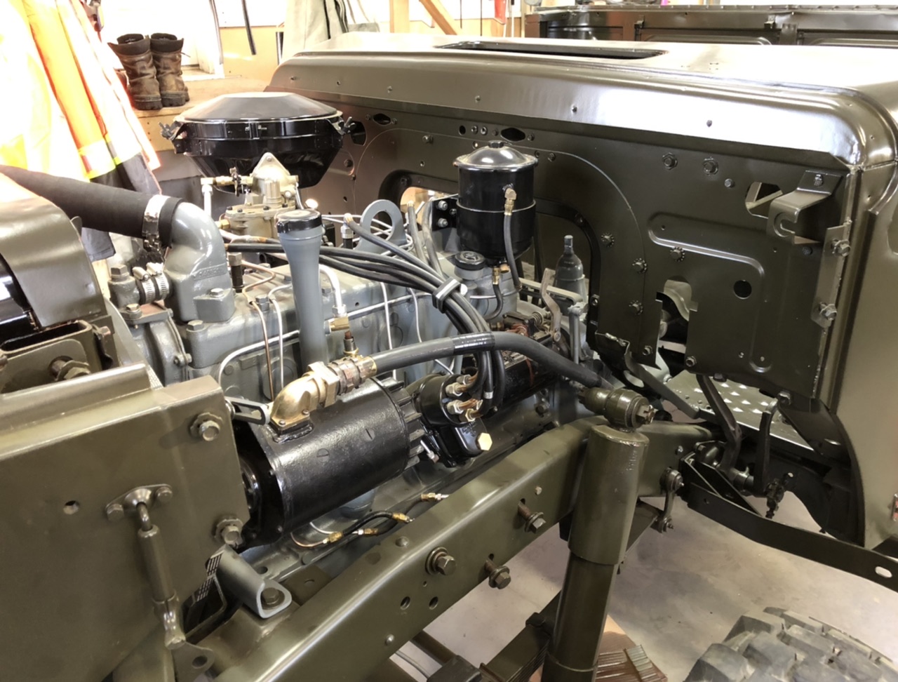

Old 15-03-21, 07:27
Wayne Hingley's Avatar
Posts: 743
I rebuilt and installed the steering box along with the left side front fender. I used a modern signal light switch with the solid state flasher. It seems to blend in OK.
19F251AC-CA2F-4ED6-9168-EAD6808BB6A7.jpeg   5F7EA145-700C-48C4-9BFE-10AB57244AA0.jpeg   6C90DBE1-AC7C-4598-9FB0-B25FB3238A78.jpeg   left fender.jpg
