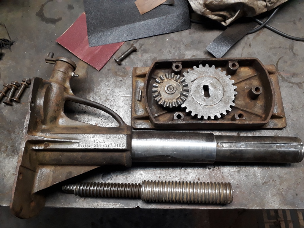

This the jack i found. Need restoration a reproduce parts missing.

The piece that seems to be missing is a cover that touches the main body and accompanies the mobile part. A kind of bushing that keeps everything in place without allowing both screws to rotate and act.
I don't know if you understand what I am describing .... I have a hard time using technical words.

No Jacques. An intermediate tube is missing...

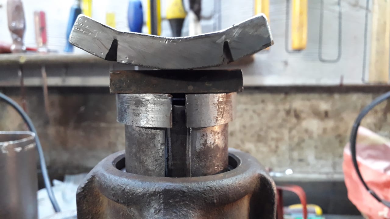

Today I started to reproduce the missing tube. Take a tube of greater diameter and with a longitudinal cut reduce the diameter to the necessary measure. Then a bit of lathe to lower the tube to the necessary diameter since it was cylinder with blows and there was not a perfect circumference.
Next weekend I will continue with the restoration. It remains to have some guides so that the piece does not rotate, and the upper seat.

I have some questions to know how to advance in the construction of the saddle and the ring under the saddle.
Is the ring fixed to the tube that is under it or does it also rotate with the saddle?
If the ring is fixed, is it welded to the tube?
Thanks in advance

The saddle rotates in the upper tube. The tube does not turn.
There is a large round head rivet that holds the saddle to the tube. it is free to rotate also in the tube and the saddle. Without pulling mine apart I am not sure how the rivet is attached to the upper tube. The saddle rotates in that collar at the top of the tube. That is the ring you refer to in photo. It is part of the upper tube.
Again, I am only referring to the smaller jack but in the photos they seem the same at the saddle area for both size jacks.

Now I know how this whole system works and I will try to reproduce it as accurately as possible.

Adjusting tube and making the saddle

The saddle

Thank you Tony! Jack works again! Now need paint!
