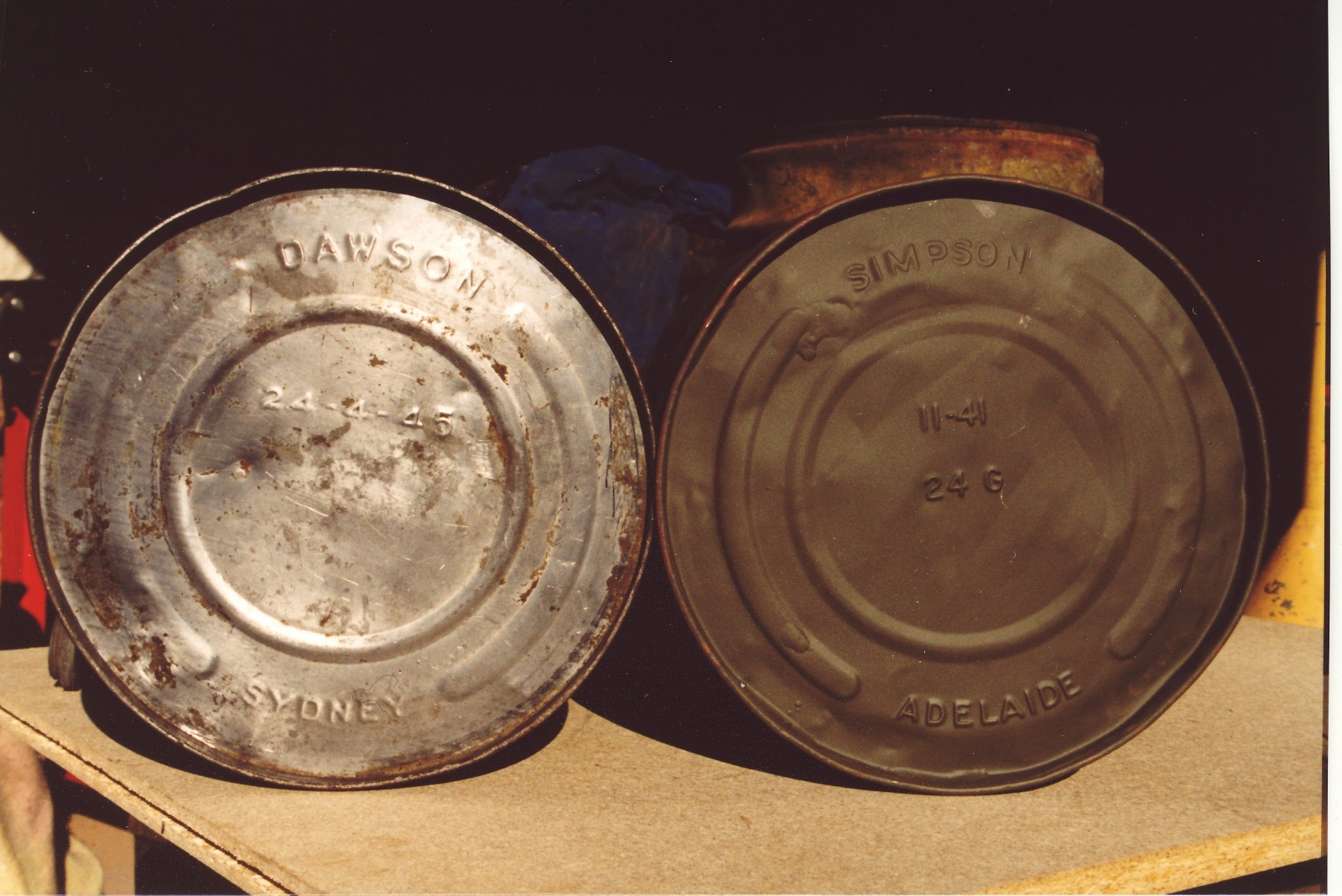

Default Latest production?
How late were the 2 Gal cans manufactured for the military?
I have a few W^D 20lt jerry cans from the early 50's, and had thought that these superseded the 2 Gal types.
But on Ebay UK at the moment is a 1955 dated 2 Gal can (https://www.ebay.com.au/itm/VINTAGE-...YAAOSw8b1gSKcV)
Were they made much later than the mid-50's?
Meanwhile, yet another listing on Ebay shows and ad for an Australian Oil Company from 1949 promoting surplus British 20lt cans filled with engine oil.
https://www.ebay.com.au/itm/Ampol-Mo...QAAOSwQwZaVsqe
So by 1949, the British Army was already disposing of surplus 20lt Jerries, but was still making 2 Gal cans in 1955.
  #159
Old 08-04-21, 14:38
Tony,
That can on Ebay is actually a WD Water can as it does not have the 'petroleum' script embossed on it. I have a new unissued one dated 1950's era painted in gloss Deep Bronze Green with WATER stenciled on the side. There were still vehicles in service at that time, that had stowage for 2 gallon cans but not for jerricans.
As for the Ampol jerrican, over here in UK a friend recently bought an old jerrican with Shell logo and oil grade on it, so they were obviously utilised after the war when there was a shortage of steel.
regards, Richard
