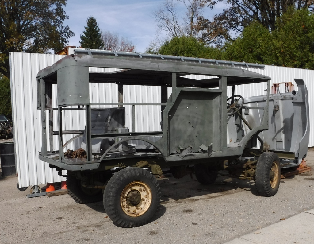

Default HUW Progress at last!!!
I got the HUW back from the sandblaster today....couldn't be happier. Here's as recovered, stripped, and now sandblasted.

Old 21-10-20, 05:23
Robert Bergeron's Avatar
Join Date: Nov 2012
Location: East Central Canada
Posts: 1,532
Nice looking truck there Bruce !

Old 22-10-20, 04:28
Good to see another C8A being restored
Do you remember your HUW was one of the first CMPs Geoff wrote a restoration log about?
See http://www.mapleleafup.net/vehicles/.../restore3.html
This poor truck got pushed to the back of the garage more than once (for the Fox and two Victorian era house renovations). The upside is that over those years I've been able to find almost all of the missing bits and have managed to get good information to be able to rebuild the correct interior. It's been kept warm and dry waiting for this day.
