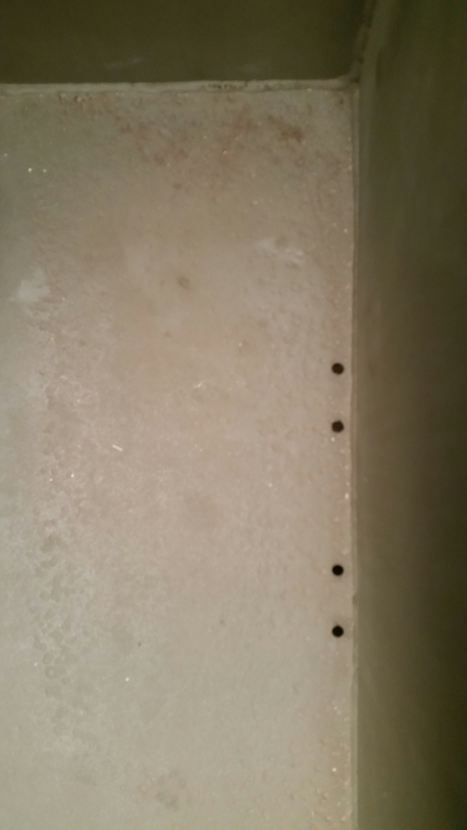

I'd be keen to know more about this. My Brit. AOP Mk IIIW has two lots of two holes just inside the hull side armour, that look like they would take the rubber mounts. I'd like to know more about how the other end of the No.22 base was fitted.

Hi Petr,
I think that's a view of the support for the left hand mounting of the front wireless position.
If you take out the seat pan, then you only have the right-hand mounting bar for the radio/charging set table. There must be a corresponding left-hand mounting bar (with rear-facing cone at the front and bolt hole at the rear to match the one on the right hand side, and I think that drawing is a head-on view of the bracket that supports it.
The two mounting bars then support a tray (probably steel angle with holes at the rear to match up with the cones and plates to bolt to the holes at the front of the tray/well of the carrier) which will have either table mounts for the WS19 (and a terminal block for the 12V supply) or a frame and loops/clamps to retain the charging set. The trays will be identical in size so they can be swapped for WS19 at front/Charging Set at rear or the reverse.
I'll find a piece of plywood or chipboard and see if I can make a mock-up of the tray and table clamps with the carrier and set (etc) on top so you can see what I think it should look like.
Chris.

Hi Chris,
yes thats correct, AOP doesnt have folding seats so this supporting bracket is a must here. On UC wireless set carrier is supposed to lay on the lowered folding seat.
What surprised me is that mounting bar on the drawing is definitely not the same as on my carrier and also shape of the WS carrier looks odd. I would say its not No.21/22/23/25 - any of these. Perhaps again something special? What do you think?
UCw Mk.III

Originally Posted by Petr Brezina View Post
Hi Chris,
I think the drawing is only supposed to refer to the support bracket (the set carrier is a "this is a quick sketch of what goes on top but I don't have the details and you don't need them yet" - indicated by the broken ". _ . _ ." line used for that part of the drawing).
I suspect it's a permanently-fitted Carrier No.21 as the AOP Carrier is a single purpose vehicle and there's no reason to have the set removable for use as a ground station.
Best regards,
Chris. (Still not convinced about the single mounting bolt and "rest it on the seat pan" idea for your carrier. It seems a bit insecure to me - especially for cross-country use.)

Thanks Chris, thats very useful discussion.
You can be right about the sketch, true is that we still dont have any drawing with the carrier and WS mounted in the UC.
Regarding the folding seat - there is a welded plate coming from the engine cover which supports seat in down position, you can even bolt seat to it (mine is missing hole in it, but should be there - now I believe to know why is this that hole there for - no such hole on the gunners side). So I believe that it could be very rigid and sturdy support.
Im obviously missing something WS carrier is locked in on the outer edge of the seat.
