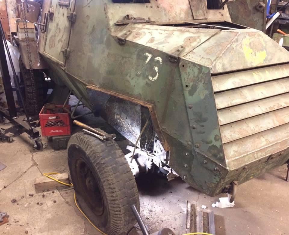

Front fender removed. At some point in the Otters life the fender flares on all fenders had all been bent in. Now the process of bending them back begins. I also have to make a new front left fender.

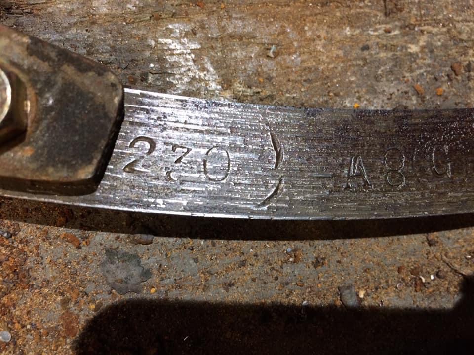

Lastly some interesting stampings found on the turret lower bearing race.
The -010 I’m wondering if it would be a shim size. When I removed the bearing race there were a pile of shims that came out with it. I’ve saved them all. I didn’t measure them but they did look to be about 10 thou thick.
