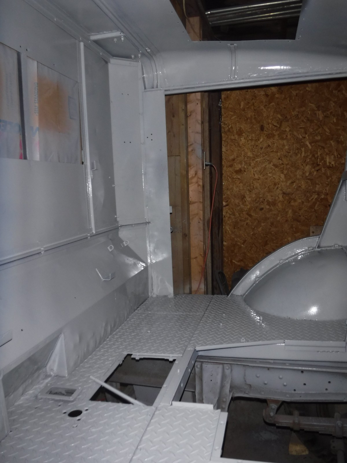

Window test fitted to the rear door. It will need some tweaking and a rubber seal between the frame and the door.

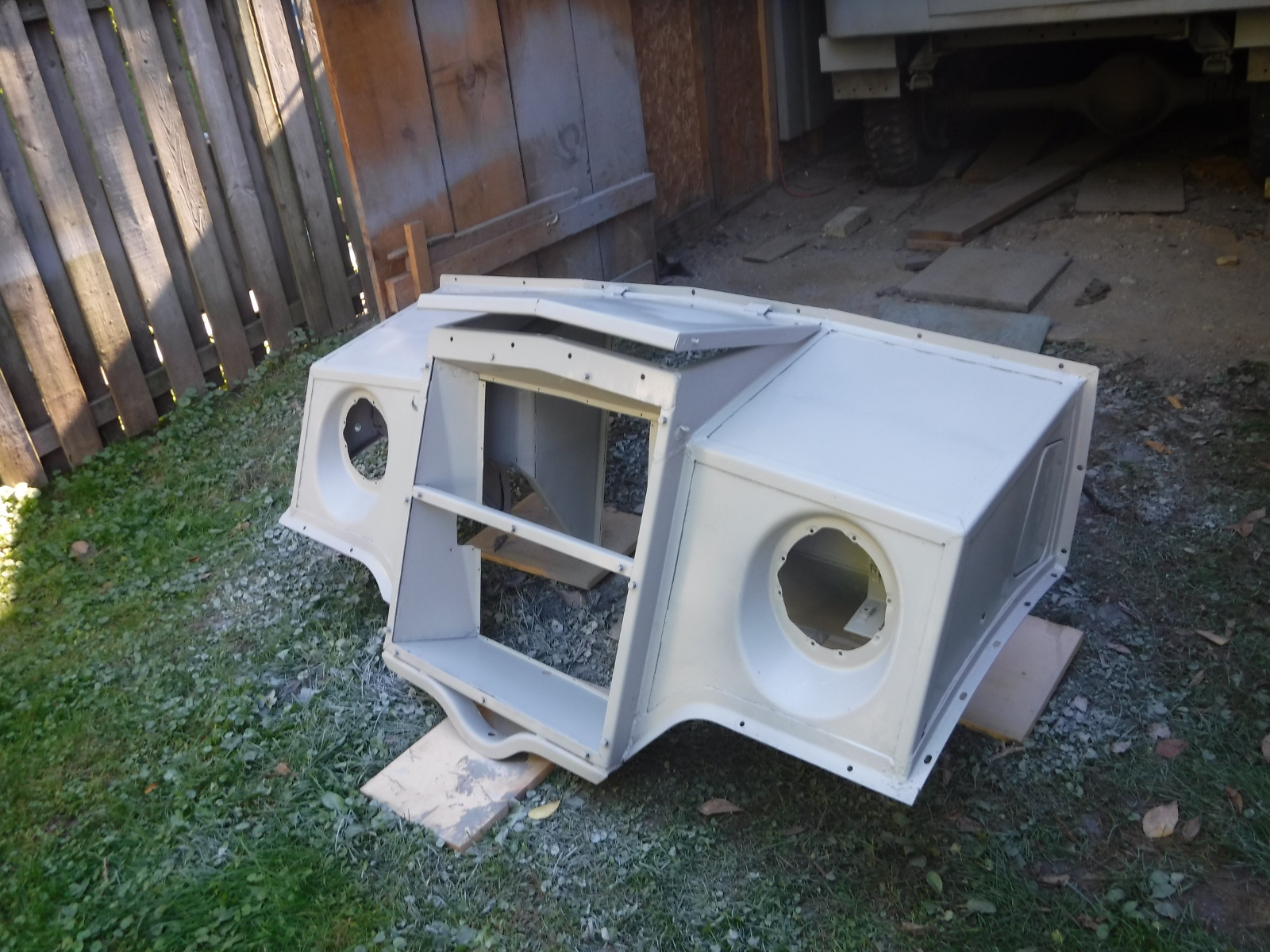

I test fit the front cowl today (before I go on, two points: asking your wife to help with something like this risks divorce, and it's amazing how the neighbour from two doors down offered to help "any time I needed him" but only after he watched the wife and I wrestle the cowl into place).
Not all that satisfactory as the years and moving the cowl around have obviously warped it a bit and it will take some doing to get all the holes lined up.
