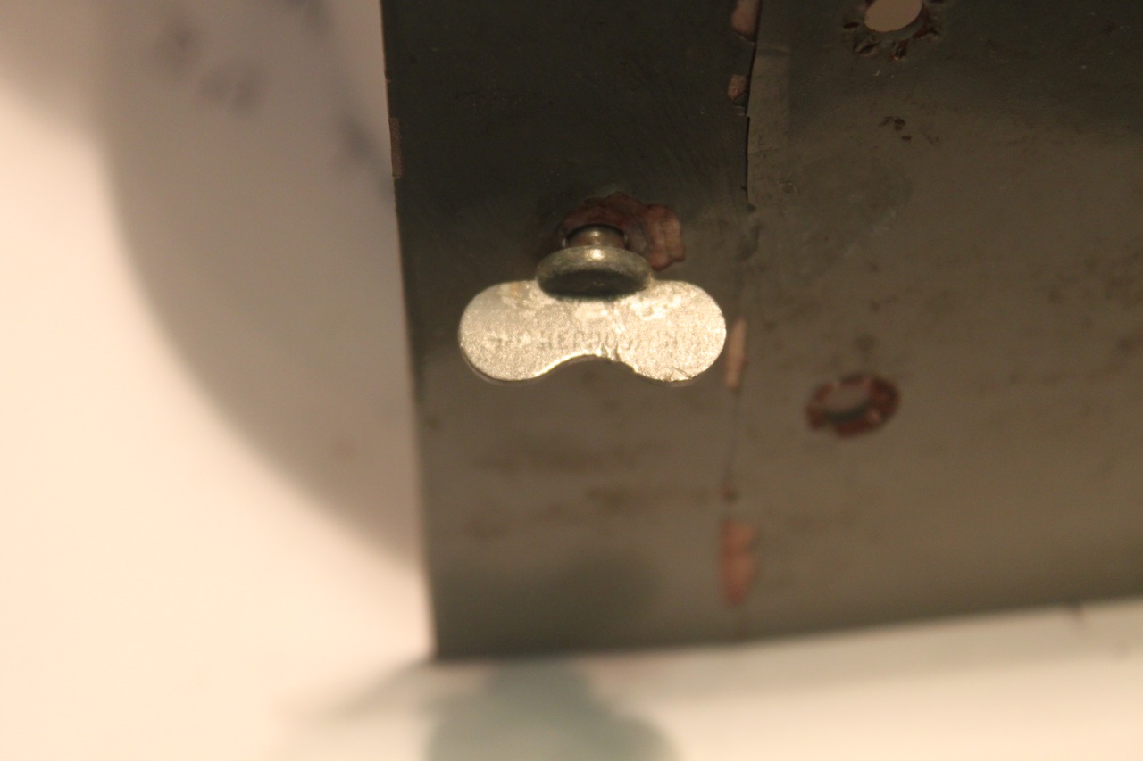

A bit of an ‘Errands Day’ today, but I have managed to remove the Vibrator Supply from the Supply Unit. A simple enough task as one just removes the two drop leads from the front clips, unlocks the two Cowl Fasteners and pulls on the handle.
In Photo 1, you can see the two side flanges of the inner sheet metal case for the chassis of the Vibrator Supply and at the back bottom, the small square cut-out in the case that allows the three banana plugs to connect with their sockets. These are the +12 Volt and Ground Input Feeds and the +150 Volts and Common Ground outputs.
In Photo 2 you have a side view of the Vibrator Supply Cover stuck in position where it blocks access to the right side upper and lower Rotary Transformer Mounting Hardware quite effectively. Note, however, the delightfully clean look of the chassis. Apart from the heavier staining/dirt at the very front and top surface of the chassis , the rest is just upper surface dust. I am being spoiled!

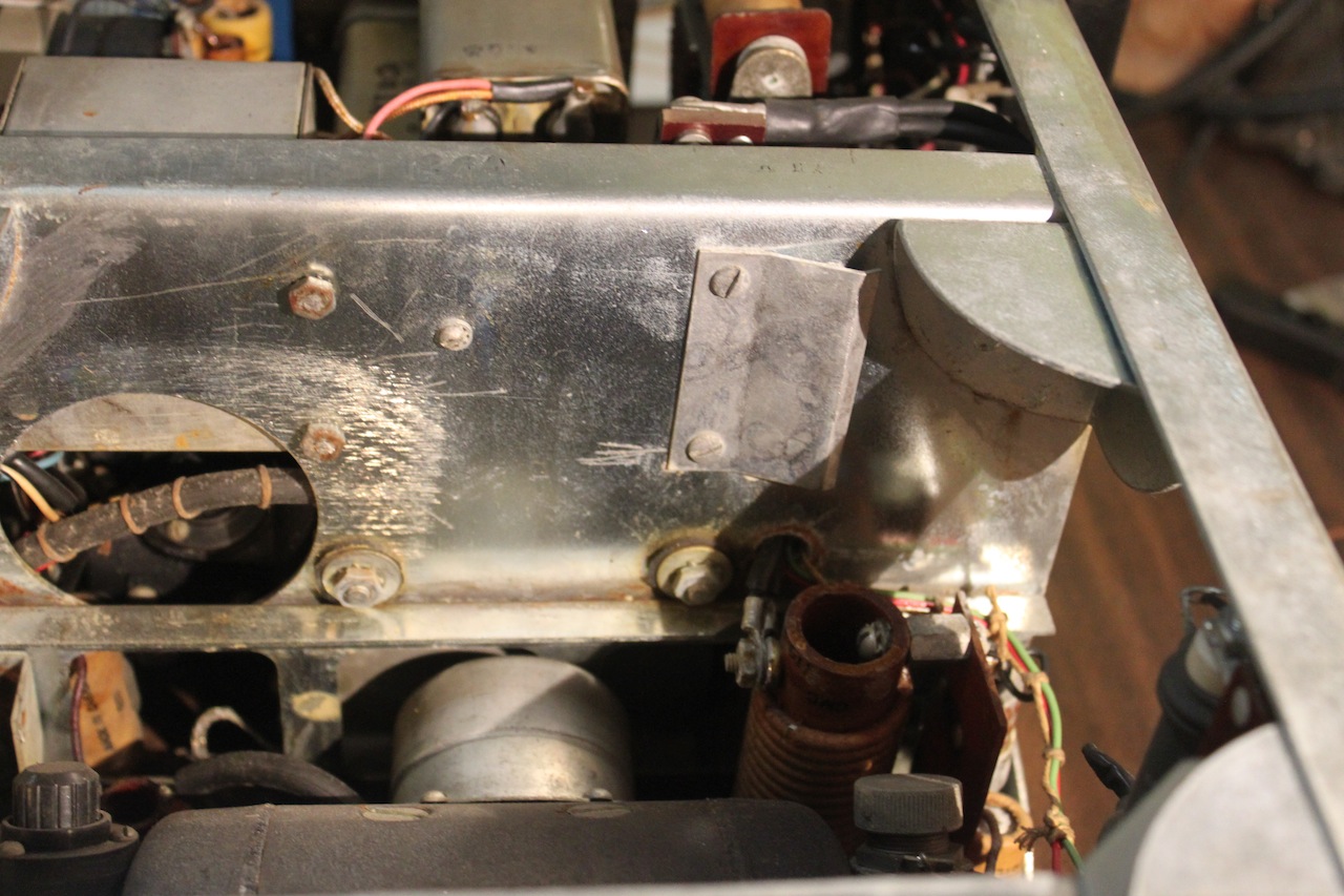

The mid-level shelf plays into this saga at this point so I thought I would start there with a photo of the three components mounted to it. While taking this photo, I noticed through the lens, the trace of part numbers along the face of the shelf, directly below the middle and rear components. A check of the photos Jerry Proctor posted of the 52-Set Supply Unit on his website confirmed these numbers should have been there, along with similar numbers stamped onto the side of the front component and the one directly above the middle one. Large black Roman Font with a heavy overcoat of varnish. All these had been very carefully cleaned away. Why, I wonder.
From left to right, these three components on the shelf are:
L28A, the AF Choke (Smoothing Filter) for the MG1A LP Rotary Transformer.
L26A, the RF Choke (Smoothing Filter) for the MG1A LP Rotary Transformer.
S11A, the Dynamotor Input On/Off Switch relay again.
The second photo goes back to the underside and the shelf again and the visible hardware. Note the small BA screw securing the L26A RF Choke above it. This screw, and two others in the entire Supply Unit, are the only ones I can find that still retain their factory original internal toothed Shakeproof washers. Virtually every other Shakeproof washer has been replaced with much larger thickness external toothed washers. I checked both editions of the Parts Listings for the 52-Set and these heavy-duty external toothed washers are not listed at all. They do not show up in any of the other 52-Set components either.
One might think that is no big concern, but take a look at the third photo today. I have slid the Cases, Metal C1 for the Receiver Vibrator Supply back onto its tray in the Supply unit, carefully levelled it and slid it in as far as it can go. It hits the front left hex nut securing the large L28A AF Choke on the shelf above and stops dead! That external toothed lock washer is far too thick. If you look carefully at the hole in the hex nut, you can see the end of the machine screw is set back in the threads of the hex nut. It is not flush with the face of the nut. In fact, the setback is suspiciously similar in depth as the amount of space needed for the Cases to clear the hardware completely. The only way you can get the Cases to go all the way down its tray is to apply a lot of downward force on it to flex the front section of the tray down far enough to get the leading upper edge of the Cases under the hex nut. As soon as you release that downward force, the Cases is stuck and the only way to get it all the way into the Supply Unit is to block the front of it with a piece of wood and pound it home with a mallet. Remember the big long gouge along the top of the Cases in the last photo of Post #765?
I know that the upgrade kits for the two Rotary Transformers in 1945 included new sections of wiring harness. This new harness was all done in solid colour plastic sheathed wire, as opposed to the factory original white cotton and trace style of harness. Most of the Supply Unit would have to have been disassembled to do all that replacement work and from the wiring part, it was done very well. The looms that had to be disassembled were all very neatly relaced when finished. You can see a mix of all original, all new and blended throughout the Supply Unit. What I do not understand is why they replaced all the Shakeproof washers that had a great international reputation for being very reliable electronics hardware, with these big, external toothed washers that did not fit properly, when all the original hardware was right there in front of them in the first place?!? Crazy!
Time for some Egg Nog!
WS No. 52 Supply Unit 22.JPG   WS No. 52 Supply Unit 23.JPG   WS No. 52 Supply Unit 24.JPG

After taking the time for a closer look at the bend in the lower section of the front panel of this Supply, I have decided it is not as sharp a crease as I originally thought. I am now of the opinion it can be carefully tapped out with a bit of careful hammer and dolly work.
That being decided, the next task in this project will be removing the front panel and getting said task completed. The end goal, in addition to the removal of the crease, will be a new coat of Gloss Navy Grey for the panel itself and the cast zinc Handle. This will bring these two pieces back in line with the fact they never got an overcoat of varnish at the factory as no decals were involved in their assembly on the line.
It will be a simple disassembly. Only two SEMS Self Threading Screws, just below the Handle, and the Handle itself, fasten the front panel to the chassis of the Supply Units, Vibratory.
One point of caution with the Handle on this Supply Units, Vibratory. It is meant to remove this sub-assembly from the Supply Unit of the 52-Set only. The Supply Unit is a heavy bit of work, Yes! The Handle mounted centrally on the front of the Supply Unit was designed to get the complete Supply Unit out of the Carriers No. 4. If you find you need extra leverage, it is best to undo the two Cowl Fasteners holding the Supply Units, Vibratory in place and pull it and its Case out first. Then you can reach in with your hand and grab the Supply Unit Chassis to help pull it out of the Carriers No. 4. The Supply Units, Vibratory is only held into the Supply Unit by two VERY TINY pins on the ends of the Cowl Fasteners and they are sitting inside a pair of very thin, spring steel receptacles. Those receptacles are ‘unobtainium’ at the moment.

A little, but productive, task today.
I cleaned up the heads on the two Studs, Cowl Fasteners, Shakeproof while they were still attached to the front panel of the vibrator supply. I have been very curious about these parts for some time. I will also be asking Shakeproof about these items in the New Year to see if more answers can be found and some ideas confirmed.
In general, these Wing Head Cowl Fasteners, like their larger ‘AirLoc’ cousins, which are also used on the 52-Set, come in various stud lengths. These lengths are typically number coded and I do not as yet fully understand how that coding is based. In general, I believe the larger the number, the longer the stud length and the stud length is determined by the distance, or space the stud needs to pass through in order to have the small pin at the end of it engage and lock into its spring steel receptacle.
The 1945 Issue 1 of the Illustrated Parts Manual that Canadian Marconi created is assembled in sections and that makes it very easy to find things once you become familiar with the layout. The down side to this, however, is this manual results in a lot of repetition. Any parts used in the Receiver, will also show up in the Sender Section and the Supply Unit Section and anywhere else they were used. The 1949 Issue 2 of this manual removed all that duplication so it is a smaller size, but in some circumstances more vague to work with when trying to sort parts out. These Shakeproof Cowl Fasteners are a good example.
A pair of these Shakeproof Cowl Fasteners is used on the Receiver Vibrator Supply, and another pair on the Blower Access Door on the Sender. The two sets are different sizes.
When I was working on the Sender, I found the upper cowl Fastener was a Shakeproof 18. It locked, but the pin in it was bent in a ‘V’ towards the end of the stud and it looked like only the very tips of the pin were engaging the receptacle. The lower Cowl Fastener was not a Shakeproof product at all. It was a Dot 230, noticeably smaller and flimsier in design than the Shakeproof one. One half of its pin was broken away, but it seemed to be engaging its receptacle just fine.
When I was reassembling the Sender, I had to install new pins into the two cowl fasteners in the Blower Access Door. With them installed, I discovered the upper Shakeproof fastener did not reach its receptacle at all, the pin spun freely in front of it. Initially, the lower Dot 230 cowl fastener seemed to be working, but it was only catching one half of the pin between the receptacle and its mounting plate. So again, not the correct size on a number of levels. I then started a closer look at the 1945 Parts List. It showed that Shakeproof No. 18 Cowl Fasteners were used on the Sender Blower Access Door and Shakeproof No. 21 on the Receiver Vibrator Supply in the Supply Unit. That struck me as odd since the one No. 18 on my Sender was clearly too short. Hence my heightened curiosity about the two cowl fasteners on my Supply Unit.
It is hard to see because these items are so small, but both fasteners on the Supply Unit are Shakeproof No. 18’s, and both work perfectly. In the first photo to the left of the wing head, a classic, typewriter style lower case ‘i’ (without its dot) is stamped on the stud head. To the right is stamped an ‘8’. In the second photo, ‘SHAKEPROOF IND’ is stamped across one side of the wing head.
So my conclusion in all this is that when the 1945 Illustrated Parts List was assembled, the data for the two Studs, Cowl Fasteners, Shakeproof on the Sender and Supply Unit got reversed and the proof reading did not catch the error. Hopefully, Shakeproof may still be able to provide some information on this product regarding the size codes, and perhaps more.
