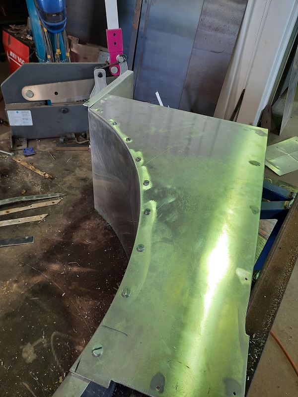

This is a part I have been putting off for a while but now needs to be done. It is the turret basket surround. it has a flange on the top and bottom and the curve is really critical as the turret basket has to turn inside it to dia and centralization are ever so important. The original I have is mostly there so there not a lot of guessing. I did however need to make a complete curve and solid ring to form the flange on.
20220121_090653.jpg   20220121_090703.jpg   20220121_090715.jpg   20220121_103158.jpg
  #1238
Old 21-01-22, 07:36
colin jones's Avatar
Posts: 1,810
I curved a piece of 40x10 flat so I had a solid top to form the flange on with considerable bracing and welded it down to my bench. I will cut it off later of course.
20220121_104950.jpg   20220121_112830.jpg   20220121_141552.jpg   20220121_142322.jpg
  #1239
Old 21-01-22, 07:40
Posts: 1,810
This is quite new ground for me as I am not used to doing this sort of work but it is interesting working out of your comfort zone.
20220121_143335.jpg   20220121_143351.jpg   20220121_145552.jpg   20220121_145601.jpg
  #1240
Old 21-01-22, 07:47
Posts: 1,810
I am really happy so far as they are turning out good. The bottom flange will be another story as it is not parallel with the top one as it follows the contour of the back part of the floor and that is curved and it also has to clear the axle cover too. Might be a few fit/cut, fit/cut before they're done but that's just how it is. There is also a series of mounting blocks that are riveted to the underside of the top flange. At least I've already made them .
20220121_151230.jpg   20220121_151238.jpg   20220121_152851.jpg   20220121_152903.jpg   20220121_153229.jpg

The first fit in the tank was a 95% success and the other 5% was sorted out in place. Kleco clamps are up there with a necessity and everyone need some in their tool kit. I was able to drill the components together in place and have them held totally firm without any movement.
Anyway I will be able to drill the mounting holes and fix in place for good.
20220125_115751.jpg   20220126_082540.jpg   20220126_122345.jpg   20220126_122417.jpg

Hi David, those pieces that are screwed actually don't come off. There will be a slot countersunk bolt approx every 4" but then there is a solid rivet in-between all of the bolts. I'm really not sure why there are bolts because there is a void underneath that has no access to On top of that flat section is a rubber matting that has to protrude about 1" or so past the int diameter. That rubber is held down by glue and a 1/2" wide strip of ally and that is screwed down around its perimeter. Now the overhang of rubber that is on the int cir will sit on top of the turret basket as that is the same height as the parts I just made and that literally has to be there to stop cartridges and any other small items dropping down and jamming up the whole thing. That will be all self explanatory in the next couple of weeks when I restore and fit them.
I am a bit surprised that void was not used for some kind of storage considering there were three men in there and not a lot of spare room.
As you won't be here to see, hear, smell and touch them on the day I get them fired up, I will video in detail the first battery hook up, power up and movement under their own power in half a century or more.

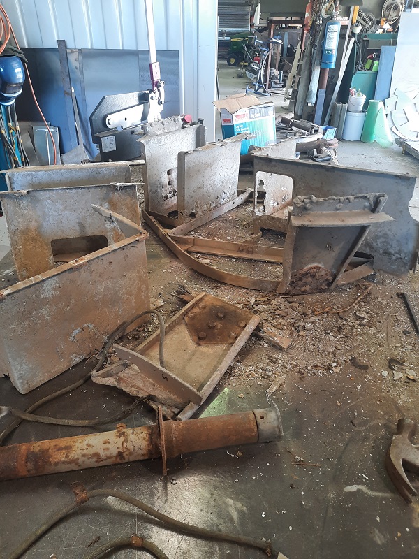

On to the turret baskets and both are almost basket cases. I think at most I will be able to salvage the surrounds as they are both quite sound and a few other bits and pieces. I will cut replacements for the both but only restore one at a time so I don't lose my patterns. There is a lot going on iside these and there is also three stays that connect it to the turret and that will be fun
20220130_132314.jpg   20220130_132339.jpg   20220130_134413.jpg   20220130_134431.jpg   20220130_160436.jpg
  #1250
Old 30-01-22, 09:23
Posts: 1,810
Just as well the shape of each component is quite solid and between the both I should be able to reproduce with good accuracy. It's incredible to see level of lamination in the aluminum and the steel parts are almost perfect. I will be a bit of a drawn out resto for these two parts.
20220130_160441.jpg   20220130_160452.jpg   20220130_164938.jpg   20220130_165150.jpg   20220130_165159.jpg

I know what you mean. I can't climb in and out of things like I used to but you just do what you gotta do
After de riveting one of the baskets and making the replacement tops, I will be able to get these two baskets back in to top condition again.

Both surrounds are in very good condition but most if not all of the internals are not but I will use as much of the original components as I can. I'm quite happy with what I have to work with. My poor workshop is in a bloody big mess so I think it's time to clear some mess before I start tripping over stuff.
