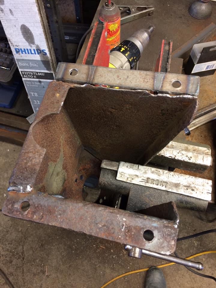

Today I got a few hours out in the shop and finished up the antenna bracket mounts. The one bracket had its mount ripped right off when it got badly twisted. I ended up making a new one as the steel had been stretched and torn. I used two magnets to initially hold the new piece in place. Once tacked I added a metal bar and clamped it all in place to fully weld it up. Once done everything was cleaned up with a flap disk.
6407DBA0-F2E5-4E5B-B64B-065EF7D2BEE7.jpg   84CD024C-1122-450B-8398-401970B13396.jpeg   17D1126B-3C49-46FC-BB72-DB69656BF97B.jpeg   EC798B2B-111E-47EE-BE72-FE92610304FF.jpeg   8BE0FF67-80E7-40D1-8748-A0BD87716B1D.jpeg
  #207
Old 13-04-22, 03:40
Posts: 4,192
Here is the new piece welded all in. I still need to clean up a bit of the weld on the outside.
I also had to add a piece that was broken off the other mount. A new piece of flat bar was cut along with the matching cutout and everything was welded in.
3F021E3F-4059-481D-8D53-E463FD9B7A78.jpeg   AF2AD198-9B80-4ED9-8C38-B892F93C91E0.jpg   EBFBB1E1-D56F-47D3-A8A6-CC90FEF60E38.jpeg   B74B7C4E-44CB-471A-B324-EDEBD41571B9.jpeg

Old 15-04-22, 03:40
Posts: 4,192
Not a bad result from the twisted bracket picture in post 201. It still needed some minor adjustments once bolted on. I got the one side bolted in but the other was out by about 1/8”. I used the 10lbs sledge to nudge it over and get the 3rd hole lined up. I bolted it then nudged it again to get the last hole lined up.
I also pulled off most of the brackets from the rear end that hold the tools. The shovel handle bracket will need a new vertical piece as the original is totally gone. Interestingly the shovel handle bracket, pick axe head bracket and the shovel/pry bar bracket are all the same as Universal Carrier parts. The one even has the CTL number cast into it. I guess when it was a good design why redesign it
BCF136E2-BF8C-4981-8CE9-275A7CC77A54.jpeg   DC495636-D90F-421B-8AF3-4B8AAAC16FD8.jpg   BEE1717E-0CAE-41FB-A355-CBAAE044A2F1.jpg   4BF8C9DE-DECC-4EC8-AB20-C96E9CA01580.jpg   3B6E37C9-7508-470C-8683-33376A32EB11.jpg
