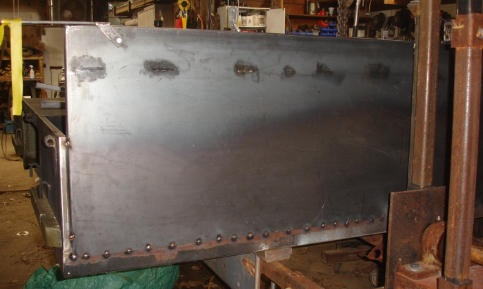

The dropsides are now firmly welded to their hinges and the bars the tailgate latches pass through are also welded. The hinge rods for tailgate and dropsides have been cross drilled for the securing cotter pins. The washers for the cotter pins on the hinge rods are a non standard size (at least for current Canadian common practice) so the appropriate size OD washer was drilled out to fit the hinge rods. Hooks were fabricated to hold the forward ends of the dropside in the upright position. (still "as fabricated" and needing to be trimmed for length). In case you are wondering - the large "left" and "right" labels were to stop us from trying to install the dropsides on the wrong sides of the truck. They had been made to be very close to the same but we didn't want to make trouble for ourselves switching them accidentally after making minor tweaks to make each fit in place...
Remaining fabrications: attach the "capstan style" tarp hold downs to the body with copper rivets (sourced, just need a few hits with the rivet gun...) Fabricate and install the tailgate hooks. Install the internal braces on the headboard. All jobs that will take a while and not jump out as huge progress...
2B1 left.jpg   2B1 right.jpg   2B1 left-rear.jpg   2B1 tail and inner right.jpg   2B1 dropside hook.jpg

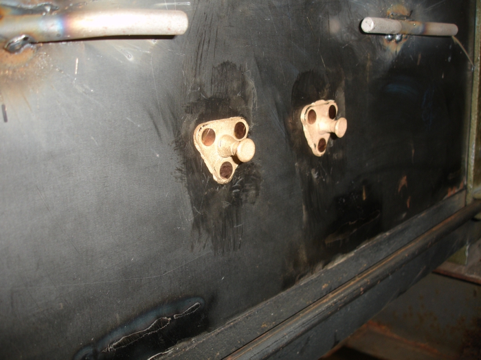

Yesterday I broke out the rivetting tools (4x rivet gun - originally aircraft rivets, rivet cutting pliers) and we installed the early style tarp securing points onto the 2B1 body (and a serious smile onto Bob).
This is another case of the appropriate tools making a job much easier. The rivet cutting pliers shear the rivet while keeping the shank round to fit the workpiece holes. The trigger style used on the rivet gun makes it much easier to do one or two taps on the rivet to get it started before finishing the job.
Bob had recovered every one of the brass securing points he could find on his property - and ended up with exactly the number needed, no spares. Copper flathead rivets were used as per original. Bob had bought a bag of 100 (42 needed for the job) to allow for experimentation, cutting failures, riveting failures and dropped on the floor and lost. In the end these only added up to 6 rivets so a bag of 50 would have been enough but the supplier's https://www.rivetsonline.com/copper-rivets minimum order of 100 had been a reasonable privce including prompt delivery.
2B1 left rear panel rivetted.jpg   2B1 tailgate tiedowns 2.jpg   2B1 tailgate tiedowns.jpg
