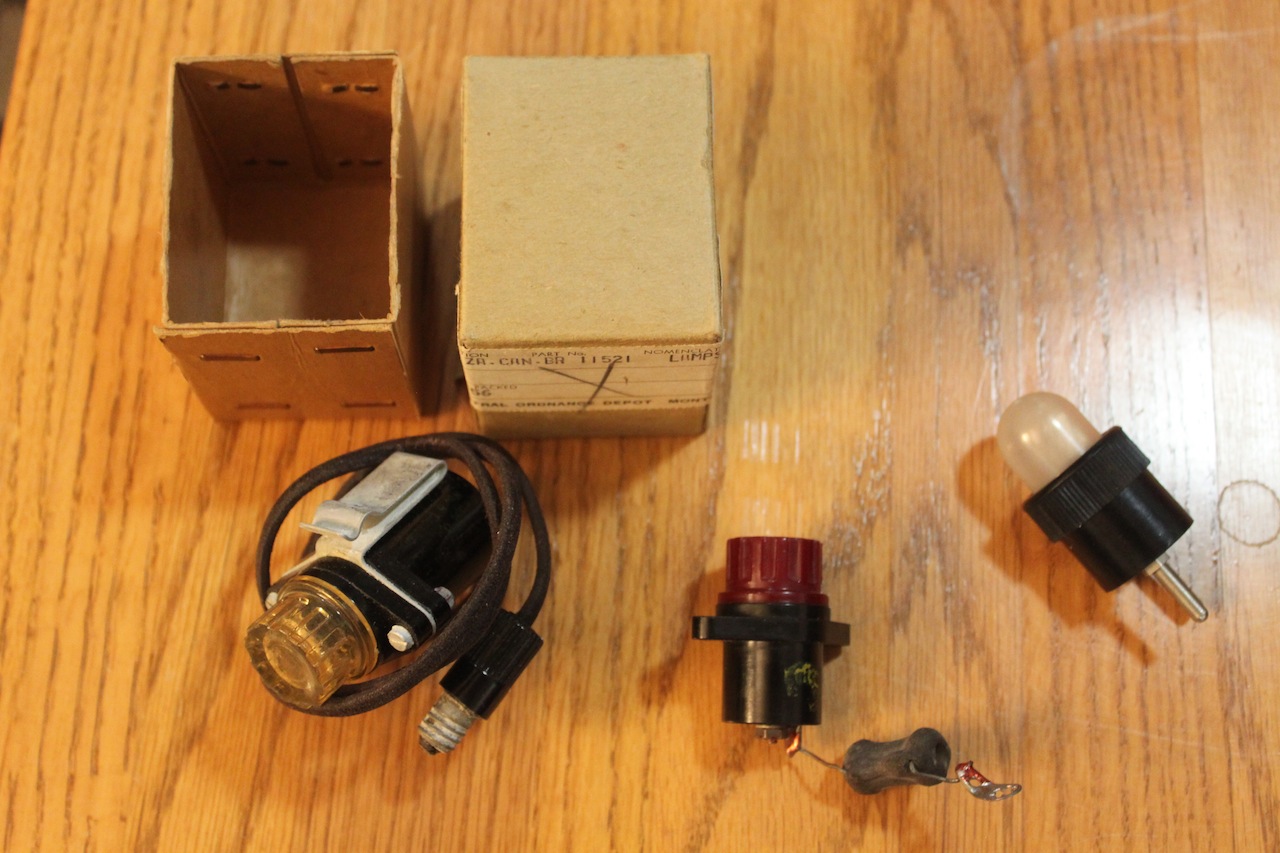

This Lamp, Operators No. 2 arrived safe and sound in this mornings mail from Holland.
With luck, it will form a key part of yet another sub-project in my overall Wireless Set No. 52 Project.

Default LAMPS, Operator, No. C1 ZA/CAN 4412
With any luck at all, this collection of items, along with a few yet to be sorted, will all come together to create a working replica of the actual Operators Lamp for the 52-Set.
It seems the cargo ship full of all the originals has yet to be raised from the depths.
