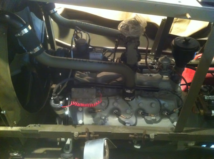

Anyway, I made up a mounting bracket for the coil so that all of the needed wires would reach it and so that it was in the air flow.
I believe it turned out rather well.

here is the original bracket as used on Ford CMP's to mount it above the generator which also helps brace the long oil filler tube.
Thanks for posting this, Jacques and Tony. I think I have one of these brackets, will look it up.
The photo also clarifies the use of the tab on the oil filler pipe, I've been wondering what it was for.
