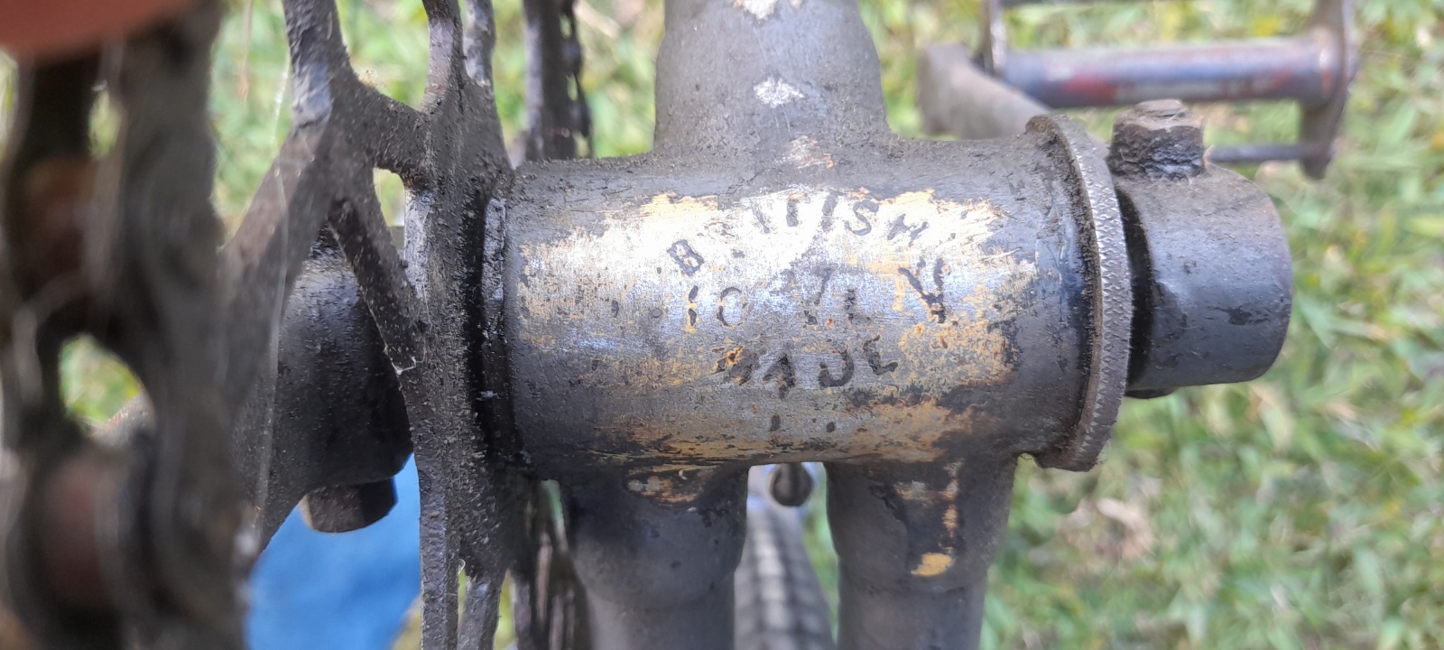

I stripped the bicycle and scraping off the paint underneath the crank I found something interesting.
Someone may know what the letters and numbers mean but there is no mistaking the D^D stamps.
The numbers on the outside appear to read 19 39 but reading the other way could also be 62 61. There is also a faint 4 in the centre.

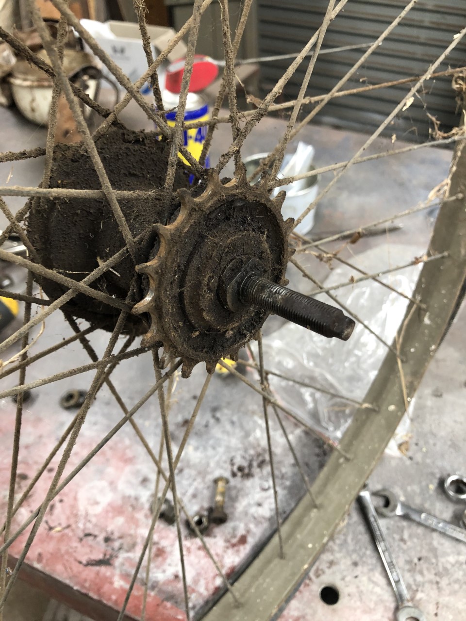

Found this number inside the rear fork

Stripped and blasted.

Jack, I am no expert but I would suggest your bike has nothing to do with Malvern Star. There were numerous suppliers and many of them were just parts assemblers using BSA and other stuff. Until forced into local production by shortages MS was largely a parts assembler itself. Is the DD British or Australian?
This has great detail photos and information on Malvern Star WW2
https://onlinebicyclemuseum.co.uk/ww...ilitary-model/
I have recently picked up a MS ladies bike dated 1943. It has the BSA main sprocket and under the frame British Made with what looks like the BSA rifles. It is a two star. The 3 is 1943 (starting 0 for 1940 and the M is for Melbourne factory)

Jack
Your photos got me intrigued so I went back to my ladies Malvern Star and sanded back in the area your bike has the D arrow D under the pedal shaft. Look what I found.
As for your bike, if it is indeed an Australian bike, both Hartley and Speedwell provided bikes during WW2. Lots of Malvern Star info but I can't find much on other makes.

Jack
You have an Australian Speedwell. Great find
