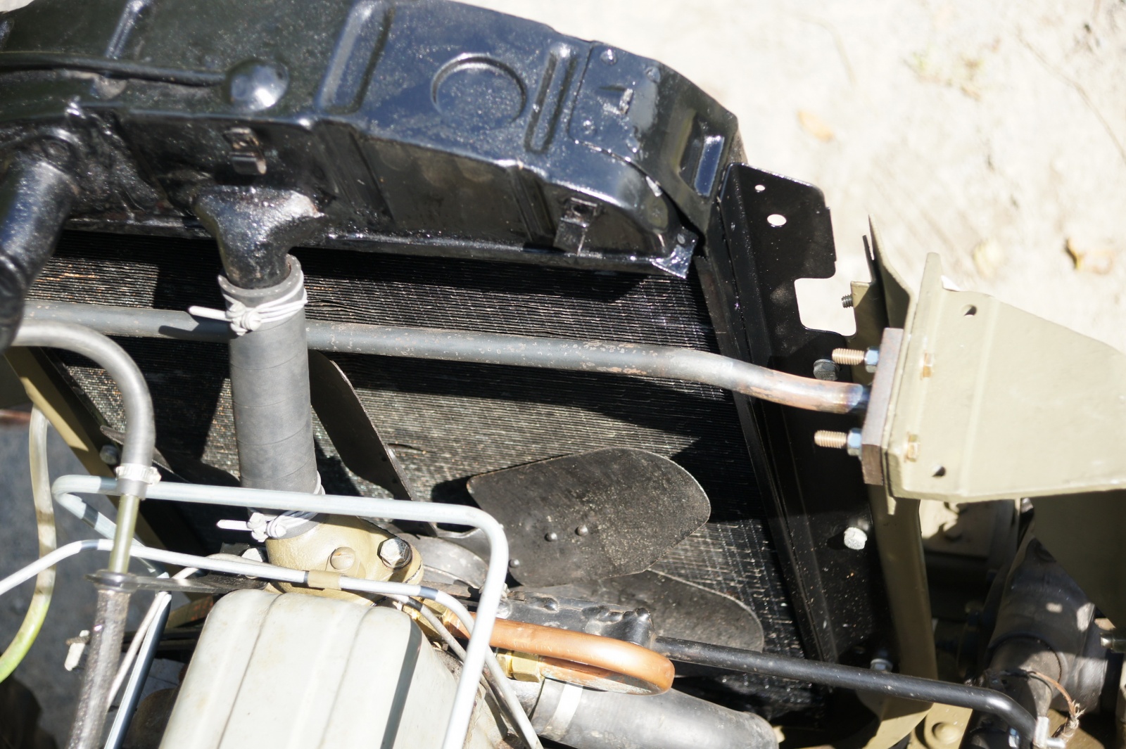

Default Bypass pipe on 216 water pump....
Original 216 water pump is equipped with inlet / outlet to connect a water heater inside the passenger cab...... it is highly recommended to install a bypass to facilitate coolant flow....... read it somewhere did not want to risk over heating the engine..... so used a rubber hose temporarily while doing short running tests than replaced with solid copper pipe.
Old 10-04-23, 01:52
Default Difference in length of pumps......
216 vs 235...... the adapter plate lifts the center height of the fan blade about 4 inches.
