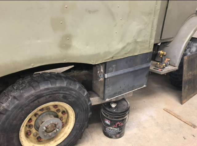

Thank you Alex .As for the passenger side tool locker a spacer is necessary because of the spare wheel well hence it is not flush with the box .

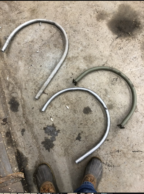

Making antenna brush guards is not an easy task . Bending that tubing without it collasping on itself is near impossible !Will continue on this on Monday .
Pack the tube full of dry sand before bending? (That was the usual approach to bending copper tubing if you didn't have a "pipe bending spring" of the appropriate size.)

Thank you Chris, certainly worth trying on my next batch of tubes.

We made a final batch of antenna protectors today . A good thing i had a complete good set of originals to copy . On the bottom right the spare tire holder .
