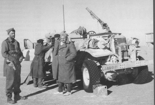

One of the details needed are the 2 front vents, what they look like and where they attach.

  1. One of the details needed are the 2 front vents, what they look like and where they attach.
  2. I don't know if the trucks used a heavy duty radiator (this CAD radiator looks a bit skinny) and fan shroud, or what that would look like
Re. 1) Good question! Must say I have not noticed them before, but now I see them:
Source: http://www.mapleleafup.net/forums/sh...ad.php?t=33332
