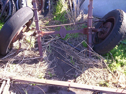

I looked at the trucks and photographed them
One had an almost gone plate that read “Wireless”
I always wanted a van for my radios
They were not for sale as her husband had passed and her brother-in-law now owned them and he was not well
In a way, at the time, I sort of wished I had not seen the wireless chassis at all

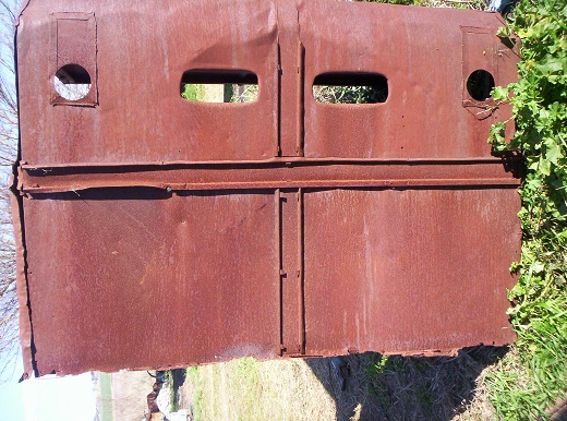

After the excitement cooled down, I had an engine-less C15 A with the remains of a drivers cab that had been chopped from a wireless van, half the floor was chopped out too, it had a strange front axle with a draw-bar attached. Rust everywhere, particularly the bottom of the rear of the cab.
The top of the cab was still squared where the storage boxes would have been. But no hatch door, no dash.
The remaining windscreen has three bullet holes!
From the clues of the drawbar and the blocks of wood, I would say the chassis had a huge steel bin attached to take grain from the paddocks

There is an extraordinary amount of parts to find, to make a truck
and they all have to be cleaned, soaked or sanded before painting

I put the tin end from the recently bought box onto the old rusty box to weather proof it a bit, so I can at least use it for storage. I will fit some pieces of cement sheet to the window openings and tie sheets of tin on the top
I have put it aside for the time being
The tool boxes will need some repairs too
