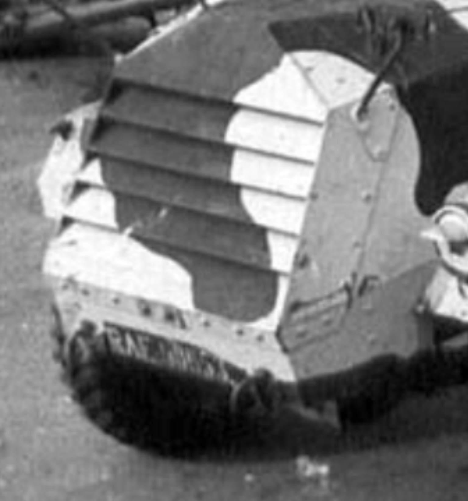

Default Engine Hand Crank Hole Cover Plate
Hello Jordan.
This item has me wondering since it strikes me as a very odd item.
Is it an original factory designed item or a simple blanking plate item retrofitted later in the life of the Otter?
If the former, I could see it being 'hinged' on one end and slotted at the other to be secured with a wing nut to help keep dirt from plugging access for the crank. If the latter, it would suggest a hand crank became redundant at some point in the Otter production, but then why go to all that trouble?
Interesting what one can find on an 80 year old vehicle sometimes.
  #291
Old 29-12-23, 02:35
Posts: 4,190
Hi David
The blanking plate for the hand crank hole is a factory item. It shows up in a lot of period pictures. The C15TA also used the same plate. I’ve included a few pictures. Some are factory shots and others are from the field.
It is a cumbersome item to remove as one of those boss head bolts need to be totally removed and the other loosened. Then the plate can pivot. I suspect that is why there is also a number of pictures of these plates missing. The Otters in Sicily with 4th PLDG all seem to have the plates removed.
As for hand cranks being redundant, sure the technology had come a ways in terms of reliability, however, I can’t think of any Canadian WW2 vehicles that didn’t come with one?
