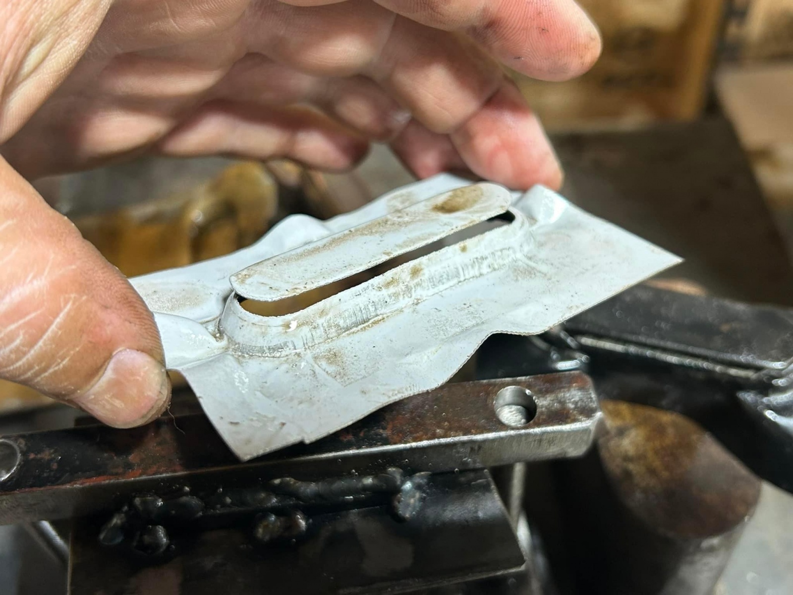

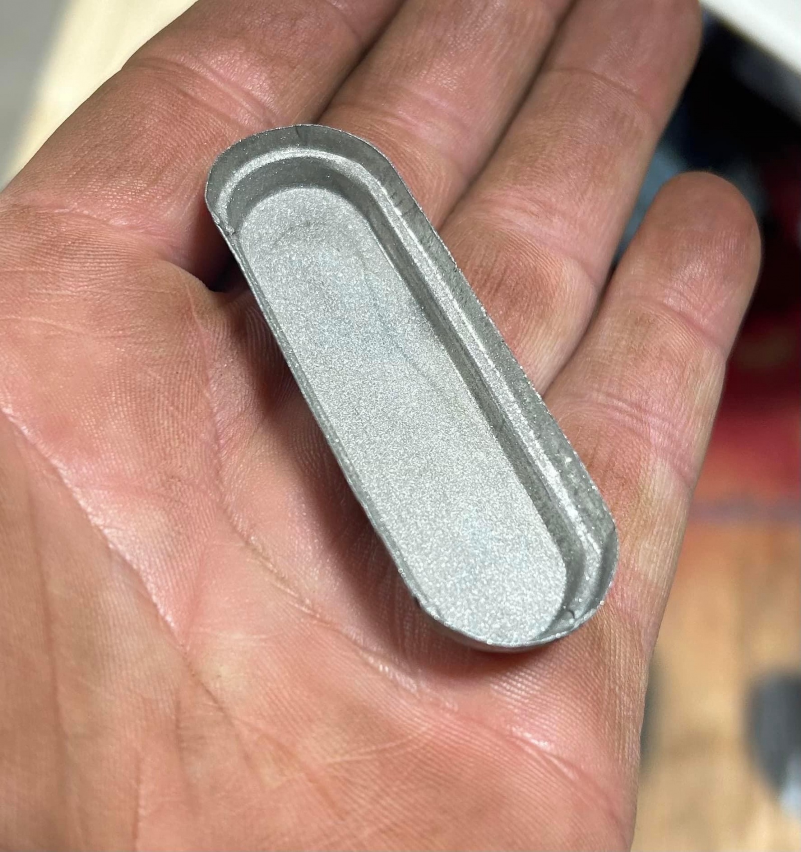

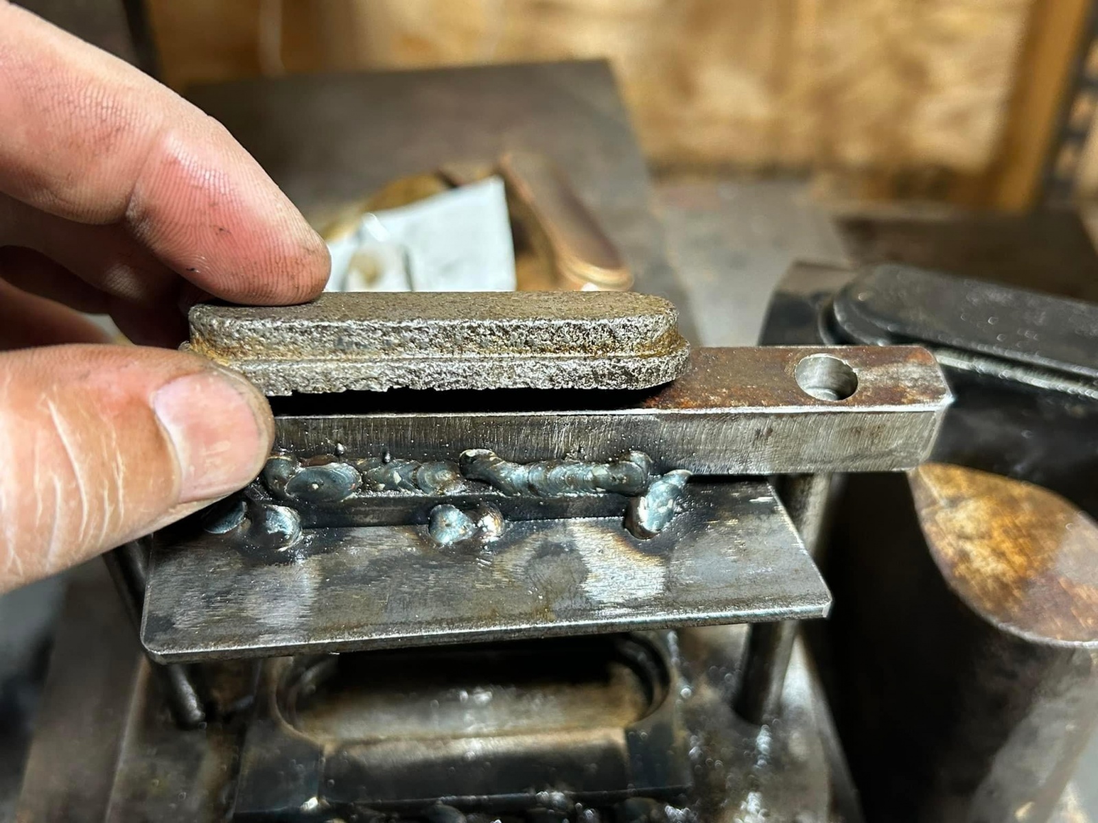

It’s all in the details…..
I needed to make up one of these stamped parts. It held a voltage reducer for two of the gauges on the dash. I made up a stamping die from bits of steel I had. With a bunch of trial and error I was able to make a stamping I was happy with it. It was a lot of work for just needing one part, especially since it won’t be seen. But…I do enjoy challenging myself to make parts.
  #310
Old 29-02-24, 05:07
Posts: 4,191
The finished stamping after cutting off the excess and sanding the edges smooth. Two of these were needed on the backside of the gauges. More detail to come another day once I sort out the actual voltage reducing insides.

The voltage reducer project is done. I’m very happy with how these turned out. I was able to reuse the original brass terminals for the one reducer. The other one I sourced out some similar brass screws. As for the actual reducer I used Zener Diodes. These drop the voltage from 12v down to 6.8v. I then ink stamped the ends to differentiate the 12v from the 6v. Lastly, they were installed on the back side of the dash on the appropriate gauges.

  #313
Old 03-03-24, 05:23
Posts: 3,721
Wow!
Nice Ink Stamping, Jordan.
That is a skill I want to investigate one of these days. A lot of wireless equipment used ink stamping for identifying the major circuit components on the adjoining chassis surfaces, usually in black, or dark blue ink. Sometimes varnished over, sometimes not. Over time, or during rebuilds, these markings are often damaged or lost completely.
Thanks for the great confirmation it can be done. I will likely be contacting you down the road for lessons!

Alex, the time spent on making the stamping die was substantially longer than pressing the one successful piece. By that point it was simply more of the challenge to see if I could stamp out a part like this.
