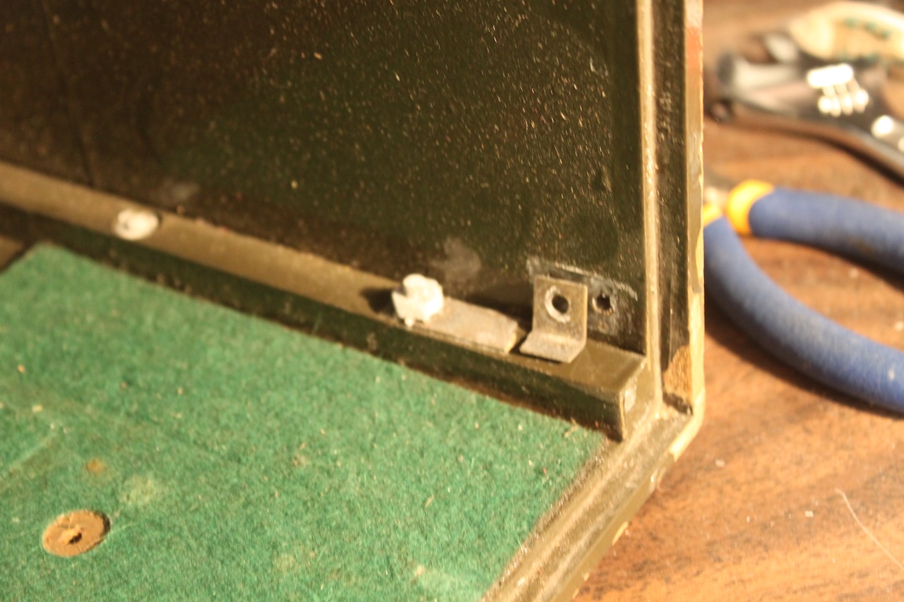

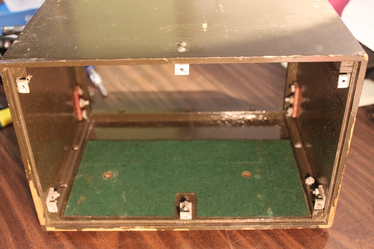

As noted, with the removal of the required six screws from the front panel of the Coil chassis assembly, it is now ready to be removed from its case. The first photo here shows these six screws removed. These screws are a zinc, or cadmium, plated 8-32 x 3/8-inch RH slotted machine screws.
The designers at Canadian Marconi Company seem to have thought of everything with the 52-Set. The coil chassis is quite heavy and rests on a large plate of 1/4-inch brown phenolic resin. This is an important insulator for the coil assembly and can be damaged, so the designers added a sheet of green felt to the bottom to the Coil Case for the chassis to rest on and this also makes it quite easy to slide the chassis in and out of the case.
To extract the chassis from the case, it must be slid forward to release the front panel from its recess. this requires a forward movement of 1/4-inch. The safest place to push the chassis forward is to place a finger on each bottom corner of the phenolic resin chassis plates where the side and bottom plates meet at the rear of the assembly. See the second photograph. Apply equal pressure to both sides and push slowly.
Remember that bottom central bracket I pointed out earlier that the front panel is secured to, in Post #1093? The one with the gap cut out in the resin plate around it? The gap behind the bracket and the bottom resin chassis plate happens to be 1/4-inch. When the resin bottom plate hits this bracket, the lower edge of the front panel will have just cleared the lower lip of the wooden case and will drop down just enough to allow the top edge of the front panel to tip away from the upper lip of the case. You can then put your fingers under the lower edge of the front panel and lift it all up enough for the bottom phenolic plate of the coil chassis to pass over the bracket and you can carefully slide the entire chassis assembly out of the case.
The third photograph shows the green, felt pad clearly in the now empty case and the last photograph shows the Coil chassis assembly now sitting on its own.
Time for a glass of wine.

The six Front Panel Mounting Brackets are another undocumented item in the Parts lists for the 52-Set. They are made from 1/8-inch thick by 1/2-inch wide, cadmium plated brass bar stock, cut into 1.5-inch lengths. These are them formed to create a 1-inch long bar with a 1/2-inch tab folded at 90 degrees at one end. Centred along the one inch base are two 11/64-inch holes, themselves centred 7/16-inches apart. The small tab is centre drilled and tapped to accept the cadmium plated RH slotted brass 8-32 x 3/8-inch panel mounting screw.
All six Front Panel Mounting Brackets are identical in their mounting to the wooden coil case with a pair of cadmium plated, 6-32 x 3/4-inch RH slotted brass machine screws, brass Shakeproof washers and brass hex nuts. If your Coil, Aerial Tuning No. 2 A has never been overhauled, or rebuilt, you will find once all the brackets had been installed, the hex nuts were secured with a dab of red lacquer. The one slight exception to the mounting process is found with the bracket in the lower front right corner of the coil case. This bracket has an additional brass fitting attached to it as part of the grounding arrangement for the aluminium plate front panel of the completed tuning coil. This fitting will get some separate coverage later, but since one end of it is also connected to the special front end machine screw for the right side Mounting Plate, these Front Panel Mounting Brackets need to be removed now to gain access to the Mounting Plate hardware later.
Coil, Aerial Tuning No. 2 A 19.JPG   Coil, Aerial Tuning No. 2 A 39.JPG   Coil, Aerial Tuning No. 2 A 40.JPG   Coil, Aerial Tuning No. 2 A 41.JPG

The last set of components to be removed from the coil case are the two brass Mounting Plates on either side of the case bottom, that support the four Airloc Studs which are used to attach the Coil, Aerial Tuning No. 2 A to either the top, or right side of the Carriers No. 4 for the 52-Set.
Each of these plated brass Mounting Plates are fastened to the coil box by three plated brass 10-32 RH slotted machine screws. On the left hand side, these three screws are all one inch in length, with matching plated brass Shakeproof washers and hex nuts. On the right side Mounting Plate, the same one inch long hardware sets are used for the back and centre positions. In the front position on this side, a plated brass 10-32 x 1-1/4 inch RH, slotted machine screw is used. The extra length is to allow for the fitting of the brass grounding strap connected to the aluminum front panel of the coil assembly. But the hardware for these plates does not end there.
Each of the six mounting holes is 3/16-inch diameter and passes through the 3/8-inch pine board bottom of the case, as well as the 1/2-inch square pine strip reinforcement found mounted in the corners of the case. From the inside, a 13/32-inch diameter countersunk hole has been drilled down into each hole 3/16-inch deep. In the bottom of each hole, in both tuning cases I have available, I have found a plated brass 10-32 flat washer with a 3/8-inch OD. These are needed to prevent crushing of the wood when the Mounting Plate hardware is installed. The countersunk holes appear to have been factory painted and I am not sure if these washers were originally fitted with dab of glue, or have simply stuck to the painted surfaces of the holes after 80 years of close contact, but not one of them was willing to fall out on its own. Each had to be carefully popped out with a thin awl.
Getting this hardware out to remove the two Mounting Plates is challenging. When the hex nuts were originally fitted, they end up just below the surface of the wood in the countersunk holes, so are inaccessible by means of a spanner or 1/4-drive socket set. This took a bit of thinking on my part to solve.
Ideally, to keep the hex nuts from rotating with a potentially sticky screw, the hex nut needs to be held in place directly. I was hoping my various parts bins might have held an old bicycle tyre inner tube from which I could punch out a nickel sized disc of rubber. No such luck. But I did find a scrap piece of canvas from which I cut a one inch square pad. I then wet it just to the point of being slightly damp.
With a little experimenting, I found that the 1/4-inch socket in my quarter drive set was the perfect size to fit freely inside the countersunk holes in the wood, while also fitting freely over the tip of the machine screw. By placing the damp bit of canvas over the hardware, I could then fit the quarter drive setup on top so the rim of the socket was resting fully on the face of the hex nut. I did this with the coil case resting on one side at the end on my bench just far enough the Mounting Plate assembly cleared the bench and the side of the coil case was flat on the surface of the bench. In this way, with pressure applied to the faces of the hex nuts, all the three sets of hardware on the left side Mounting Plate, and the back two sets on the right side, all came apart easily.
The front screw set on the right side Mounting Plate is the 1-1/4 inch machine screw that has the additional Shakeproof washer and hex nut set holding the brass grounding strap for the front panel in place. With this first hex nut/washer set removed by conventional means, the brass ground strap can be removed to expose the recessed second hex nut and lock washer. The 1/4-inch socket was deep enough that with the canvas snugged down on the part of the hex nut facing into the coil case, this set of hardware also came off easily.
The coil case now sits free of all its fittings, except for the green felt pad glued to the bottom.
