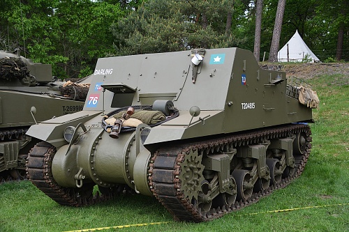

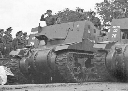

Roy Aalderson in the Netherlands is restoring a Sexton GPO and he would like to mark it as this Sexton GPO.
Can anyone help with the colours of the markings?

Sexton GPO (Gun Position Officer) “DARLING” of D Troop, 36th Battery, Canadian 23rd Field Regiment on parade in the Netherlands at the end of the war in 1945. It looks like this GPO was converted from a Sexton Mk.I (note the 3-piece final drive asssembly and M4 bogie and regular VVSS track).
Archive caption: "Sexton self-propelled howitzers passing in front of a reviewing stand at a parade. Date: 1945. This shows a parade (likely a VE-day parade in Holland) where a battery of Sexton self-propelled howitzers are being reviewed. The vehicles are from the 23rd Field Regiment, Royal Canadian Artillery, 4th Canadian Armoured Division. The vehicle closest to the stand is a Gun Position Officer variant of the Sexton."

4th Canadian Division would mean a Gold maple leaf over a green background.
"76" would be on a square with top half in red, lower half in blue.
"TLD" (Troop leader of D troop) would be on a blue and red square. From what I read on the web, 36th Battery was the second battery in the 23rd Field regiment. This would mean that "TLD" would be on a blue square, with a smaller red square in the lower right corner.
The TLD tactical sign also appears on the sides of the vehicle.

D Troop, 36th Battery, Canadian 23rd Field Regiment:
From my copy of Jean Bouchery's full colour book, "From D-Day to VE-Day, The Canadian Soldier" let me add to the conversation.
Would the War Department number start with CT for Tanks and Carriers versus S for Self-Propelled Gun? Whichever, white letters on the right rear side, above and between the rear idler and last roadwheel / or on the opposite side same location / or on the front left upper side beside the driver's shoulder.
A yellow circle with black surround and bridge classification number on the front right of the final drive. Bouchery shows a Sexton SPG with 30 as the weight.
Above the right front mudguard on the forward slope of the hull, 76 in white on a red over blue arm of service for artillery.
On the opposite side in the same location, the gold maple leaf on a coloured square. Not sure which colour background for that division.
The two upper hull markings are repeated reversed on the rear hull, the arm of service on the left and the maple leaf on the right.
Someone smarter than me will make corrections, and narrow down the particulars.

Attached is what I think the markings and colours would be. Please note that I only used a generic font to make this quick graphic, so it't not a perfect match with the picture!
Also attached is a picture of a Sexton from B troop, 23rd Field Regiment, which would be 31st Battery. Picture taken in Diepenheim 1945, source:https://mijnstadmijndorp.nl/app/old-...7&id=324200179
Also attached is a picture of a Sexton from F troop, 23rd Field Regiment, 83rd Battery. Picture posted here on the forum by Bryan Naylor in this thread:
http://www.mapleleafup.net/forums/sh...d.php?p=100364
Both pictures give an idea of the location of the markings, but Bryans picture also shows the Tactical sign of F troop, with the red square in the lower left corner of the blue background, this matches the info on the Wiki page (3rd battery in 23rd Field regiment with Easy and Fox troops) :
https://en.wikipedia.org/wiki/23rd_Field_Regiment,_RCA
This would mean that indeed the red square for "Darling" would be in the lower right corner of the tactical sign, as 36th battery is the 2nd battery in 23rd Field regiment.
last picture attached is a screenshot from the "The Royal Artillery 1939-1945" website. source: https://ra39-45.co.uk/formations-and...hicle-markings
Old 26-11-24, 17:42
Posts: 2,767
Terry, the "T" prefix on this GPO is indeed a bit "surprising" (This was also noticed by KevinT on the WW2talk), as the normal prefix for a Sexton would be CS or S. Most likely the prefix "T" was used as this Sexton GPO has no gun, and was therefor marked as a "normal" tracked vehicle.
I can't see a star or a Bridge classification on "Darling".....and the paintwork looks really neat. It could be that the vehicle was repainted for the parade in 1945, painting over the bridge classification.....or that it was only just put into service and the marking was never applied????
Two other GPO's pictured in Goor in 1945, also don't seem to show a Bridge classification (ref. http://www.mapleleafup.net/forums/sh...858#post269858).

Aalderson's Sexton GPO at the Camp Nijverdal event, May 2025. It is finished in the markings of a GPO named “DARLING” of D Troop, 36th Battery, Canadian 23rd Field Regiment, 4th Canadian Division.
A sort of "then & now" with the original photo which was the inspiration for Roy's GPO.
