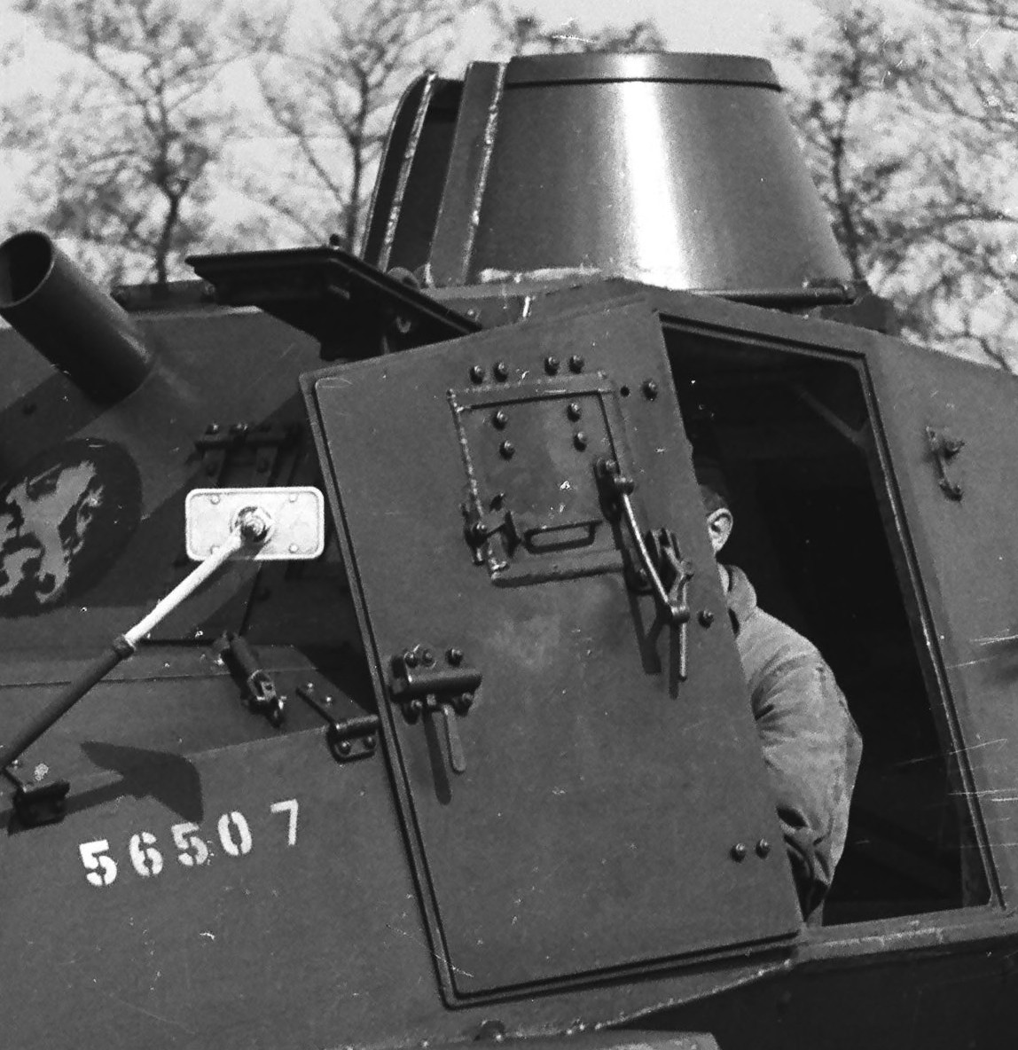

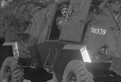

Interesting differences in these parts. It’s a shame there is not more photographic evidence to look over for these kinds of details.
Here are two photos showing details. Both were made in 1947 when in Netherlands Army service (one could even be yours?). They both seem to have the "humpback" (for lack of a better description) door locks.
ID:	140789 Click image for larger version
Source: https://beeldbank.nimh.nl/foto-s/det...c-dac9b71bad64 and https://beeldbank.nimh.nl/foto-s/det...8-31602a8e6740

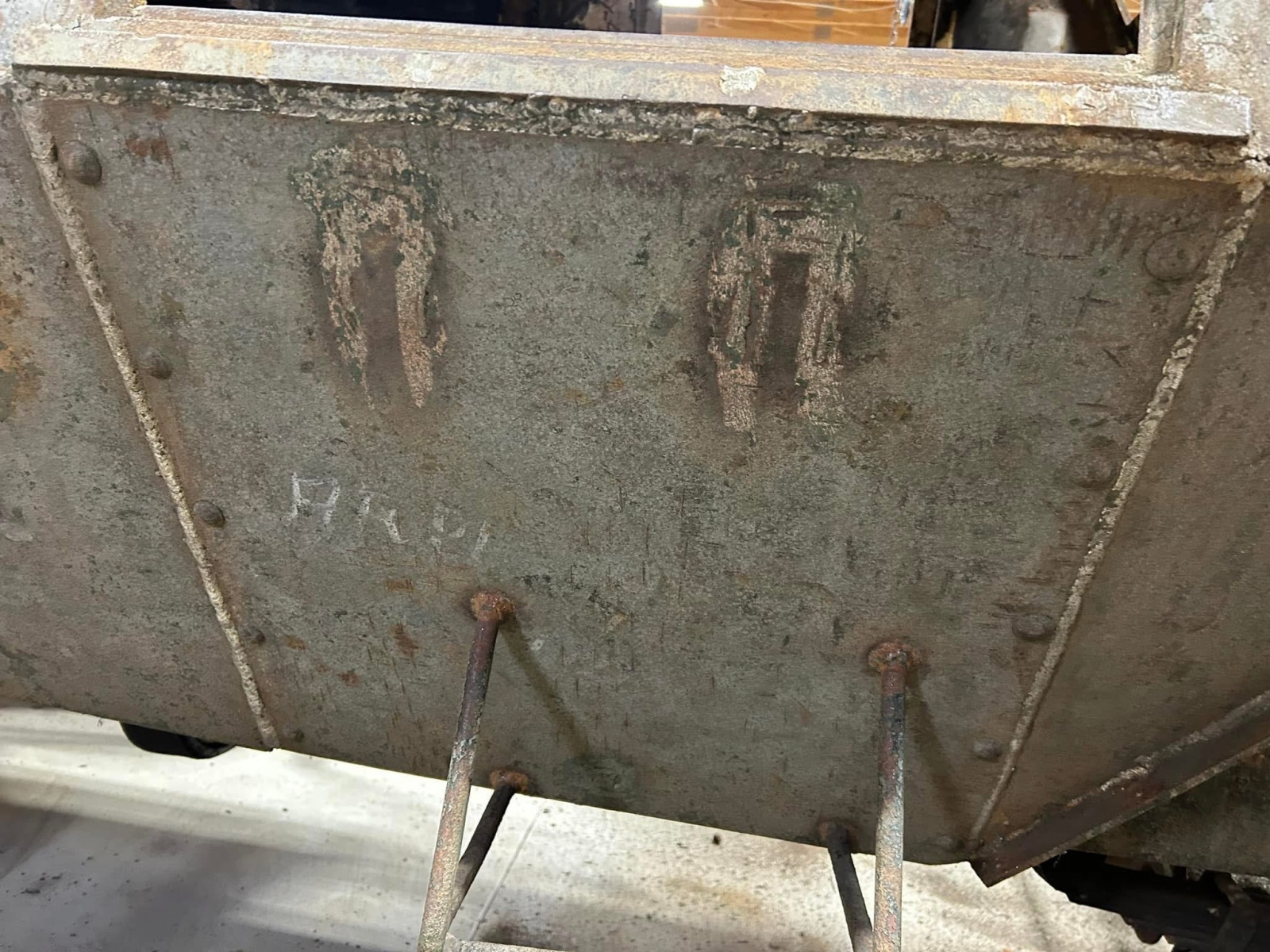

The needle gunning continues. Under a thick layer of paint I found what appears to have been a spot where something had been welded to the hull and then cut off. The location is directly below the drivers door. I’ve gone through all the Otter pictures I have and none of them have any brackets welded in that spot.
Enlarged custom step maybe? Here is a picture of a Dutch Military police Otter with similar fittings......not exactly the same as yours, but also not the standard step.
source: https://www.nationaalarchief.nl/onde...9e761e21314fe4

Alex, thanks for that picture. That step is definitely close to what the ground down welds look to be. When I needle gunned the other side of the uk the same marks were present. That confusing part is that the steps that are on the hull are the original factory ones. So I don’t understand here being another set of steps.
Tonight I attempted to remove the Dutch added spare wheel carrier blocks. These were torch cut heavy pieces of steel with a pile of weld. I spent the better part of an hour trying to cut them off with no luck.
I agree Jordan; maybe it's more like an extension of the factory step. I was just looking at some of the pictures of Otters in Surinam in another thread, and it seems larger steps were not uncommon in post-war Dutch service.....they come in a variety of make-shift designs.
