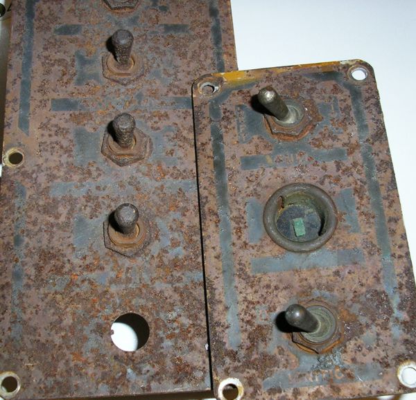

I just got my switch plates today for my CMP and I noticed that the background colour to them is brown.
In all of the photos ive taken of restored CMPs these switch plates have been a silver/grey background. Was there a different time period that the colours would be appropriate for?
My CMP is a late war one with the round roof hatch and gauges.

Jordan, as far as I know these plates were made of either brass or aluminium. I suspect the aluminium ones are late-war.

I have a NOS Ford cab 13 late pattern dash. These had steel switch plates with a light grey background. Brass plates were used on earlier models of Fords, with the small ones on cab 12s being the same material used for the gearshift plates, a sort of zinc alloy.
I'll take a pic.

This is a question I've asked for a while. With my instrument cluster and panel restorations I had to create both types of switch plates. I have seen the brass ones in Cab 13s and in a panel I restored for the Australian Rover Armoured Car that had a Cab 12 cluster and panel. The brass plates had all the detail stamped into the metal and then highlighted in black whilst the silver plate details were painted/silk screened onto a steel plate as Keefy described.
Does your smaller plate have provision for Autopulse in the central hole? This was not utilised in the Australian plates where the hole was not punched out but was incorporated in plates that were attached for vehicles destined for colder climates.
You mean hotter climates, don't you? The electric fuel pump was one of the Indian Army-specific provisions on CMPs.

Here is a photo of the switch plates. These did not come with the truck but they did come off a 13 Cab Chevy CMP from Canada. Bruce Parker may have more info as to what kinda truck they were from as I got them from him.
They are definately brown in colour. That autopulse switch hole is cut out but there is some sort of socket in the hole. There is no text below the hole. Woudl this be some kind of light to let you know ignition is on?

These look like they came from a Ford - the socket should not be there - the power for the trouble lamp was mounted on the dash.
As to the colour, yes, those ones have turned brown - when new they were pale grey.

The original colour is grey as shown in Keith's picture (with white lettering, much like a 19 set face). As to the socket in the centre of ther smaller plate, it's for the inspection lamp and is original. All Chev's with round instruments here have it. Apparently not Oz ones? Early Ford plates were embossed brass, and the centre hole was not punched out as the inspection lamp socket was mounted on the panel itself. Keith, would it be possible your plates are later Ford ones? Notice also that Chev toggle switches (at least the three centre ones in the larger panel) are a different shape. Ford ones had a pronounced knob at the end.
Jordan, the plates are in their original configuration and are from a 1944 13 cab Chev. The only other variation is really late war Chevs that had an additional switch on the large plate.

The inspection socket was always located in the dash panel itself rather then on the switchplate in Fords.
