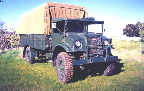

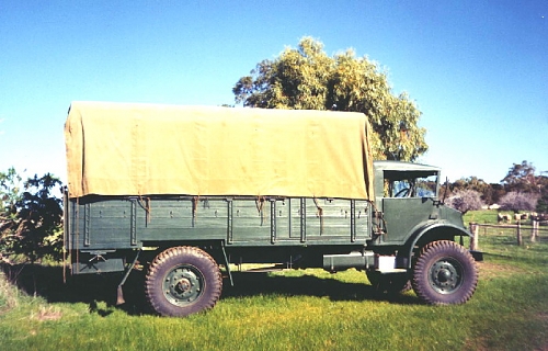

Have posted a picture of a C60L Automotive Workshop that I have , do you have any pic's that would show the lay out inside .
Jim S.
This truck has only done 3000 miles since new .
