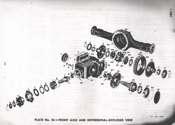

Here is the first photo from the double-reduction front axle.
It was build specially by Chevrolet for the T17E1/E2.
It is really massive, many of the parts being to heavy to be handled without lifting equipment.
Wheel bearing diameter for example is 165 mm and the diameter of the brake drums is 16 inches.
Marco
