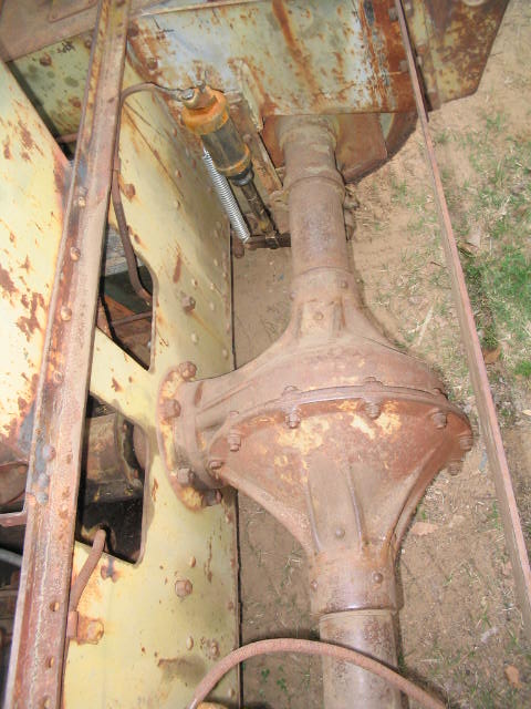

A partly restored LP1, showing the tiller steering levers connected to 2 master cylinders, and the location of the instrument cluster (1938-39 Ford truck):
Old 27-08-06, 15:22
Default Re: Australian LP1
Originally posted by Lynn Eades
I'd be interested to see ....... Did they have hydraulic brakes?
Cheers.
Lynn.
Hydraulic Brake/Steering slave cylinders:
