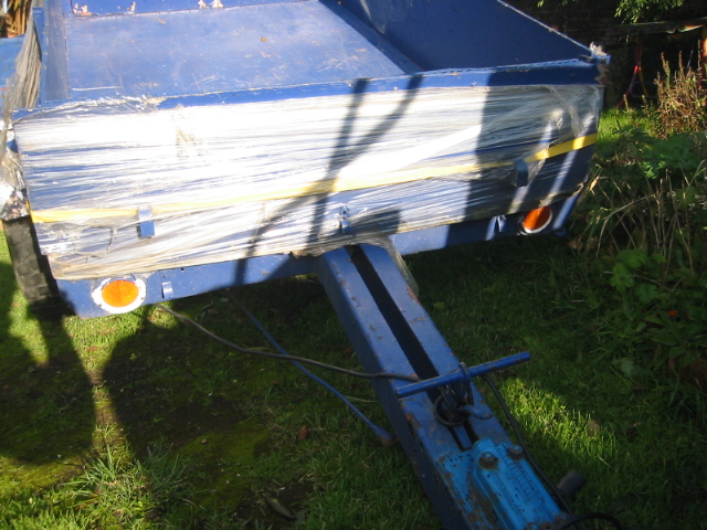

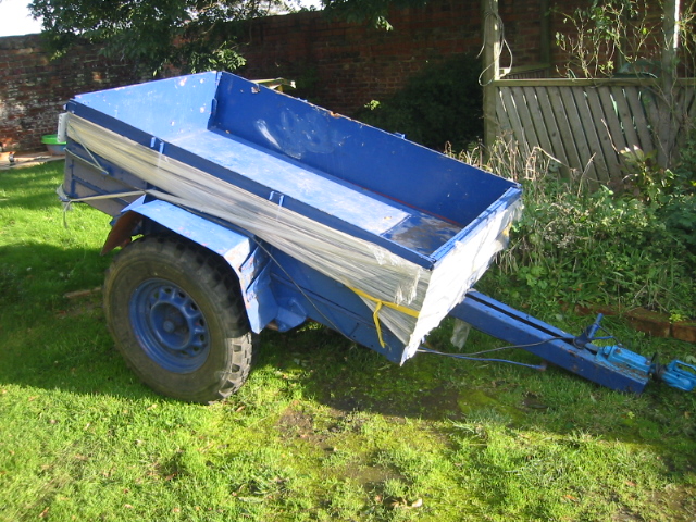

Hi Fellas
Finally managed to get the 10cwt trailer home. Interesting to see just how different it looks than in the original photos... I've had a quick walk round the job, all the timber work is replaced with plywood. It looks as though some of the steel upright siffeners have been shortened since the traier it slef doesn't appear astall as those in the pictures. the corner jack stands and brackets are missing and worst of all it seems the original owner may have had problems with the brakes on this trailer and so cured the problem by thiwing away the drums and shoes.... So I am looking out for missing parts like the stands, drums etc.. Any comments are very welcome... It looks like it was a mortar trailer. the data plate has rusted away but the rivets remain. The tailgate has been repositioned at the back using the original hard ware...
Is there a parts list for this trailer? Does any one recognise the wheels? would that be the source of replacement drums and shoes? Austin Morris?
kind regards
nick

Old 04-11-06, 22:53
Posts: 275
Default mortar trailer
Yes it is a mortar trailer, the flat mudgards I have only seen on mortar trailers, I also see you still have the handbrake lever, here in holland in the most times it is missing as far as I can see the wheels are original.
Hendrik van Oorspronk

Old 04-11-06, 23:00
Nick Bullock's Avatar
Nick Bullock Nick Bullock is offline
Location: East Yorkshire England
Posts: 174
yes the hand brake leaver is there, and I have a towing ring and handles for it, but its the drums and shoes that seem to be the big problem, and then theres the interesting modification of the wheels to take the new hubs!!!! but better then no trailer at all!
regards
nick
Old 04-11-06, 23:08
Posts: 275
Default axle
As far as I know the axle is the same as all 10 CWT trailers(mortar, airborne standart etc.) are the same, so keep looking in your neigberhood or at farmer places, here in Holland a lot were sold by surplus dealers to farmers, the trailers are mostly totaly gone, but you sometimes can find an axle under an other homemade trailer
Hendrik

Old 06-11-06, 15:48
Nick,
Seems the chassis is in good nick, though there are slight variations with the one I photographed.
Most chassis I have seen were badly rusted, most of them beyond repair really. I'd say a good buy at £53.99 + transport!
Those wheels are fitted to a variety of British vehicles. Note the come in three, four, and five lug nut versions. Your mortar trailer should be fitted with six lug nut drums and wheels.
Posts: 174
Default 10 cwt trailer
Hi Thanks for that.. Yes £50 for a trailer is fine.... no problems there. I went over to have a closer look at the hubs and wheels, both drums are gone as are the shoes inside. However on one side the apparently original hub is in place with its six studs.. so only the side in the picture is a modified hub and wheel... It looks rather like the 4 stud hub from a mini, but I could be wrong. What remains is actually very good. the chassis is straight and everything covered with paint...
Interestingly there are no signs of the three downfacing brackets on the underside of this one. I would say they have never even been fitted... Though i still don't understand what they were for????
So I am on the look out for parts if there are any out there.. be good to get it sorted out for next season....
kind regards
nick
