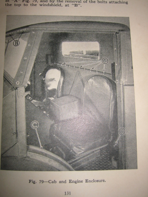

Old 01-10-06, 22:32
Default F8 interior
I have posted a large pic of the interior of a new F8 which, although the seat is folded down shows the box. It's too large to put on the forum so you can see it here.

NICK...... what manual was that inside cab picture taken from???
particularly what is the date on the manual.....
Peter.....thanks for the sketch and the picture of the original box.
Keith...... Nice picture also...... in Nick's pictures the seats looked like leather or simulated leather...... but could not make out the type of covering on the seats in your pictures.
I am really confused about where to stick my battery box..... the cab space is so small...... in fact with the additional two winch levers in my cab 11 it maybe impossible to place one.
