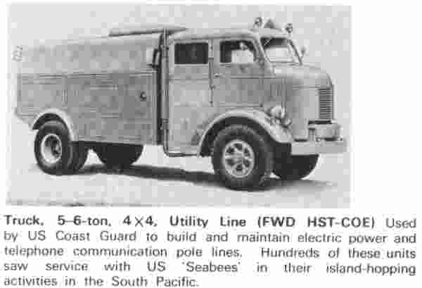

Default FWD Sigs truck
Similar but larger, USA service

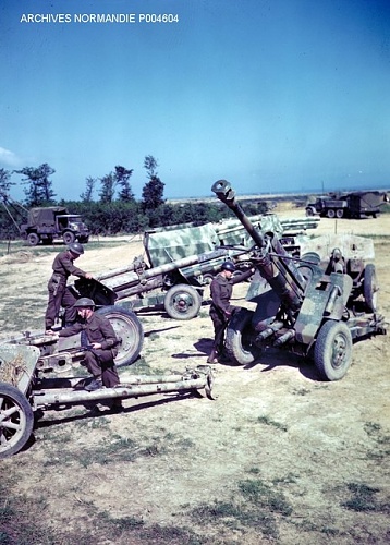

Old 15-10-06, 22:33
Nice colour pic showing a 3-Ton Derrick Truck at a captured ordnance dump in Normandy, 1944.
Source: Archives Normandie.
click here for a large size scan
A similar but much more prevalent US truck with a small but strong following are the US Army Signal Corps K44/K43 series trucks. The K44 being the auger truck, but the K43 has the derrick and winch for pulling telephone wire.
Matt
