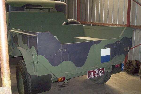

General view of the repro body I built . Plans kindly drawn up and supplied by Ian Richardson of Carnforth, Lancs. U.K.
