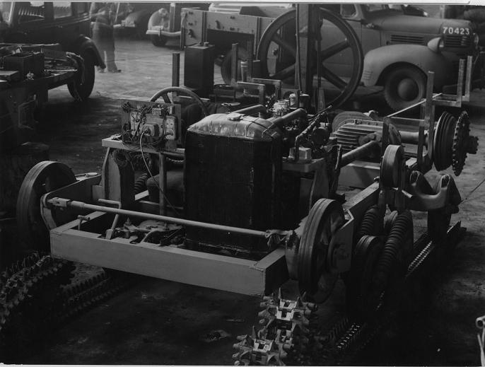

Some time ago, Keith posted pics of this naked Tracked Truck (Perhaps it was a mockup or prototype? This follows the layout of the 2pdr Carrier and Mortar Carrier, while the production TT had the Driver on the left and engine on the right.)
Anyhow, it shows the idler steering rod without meddlesome armour plate in the way: (Where does it connect to the steering wheel?)
