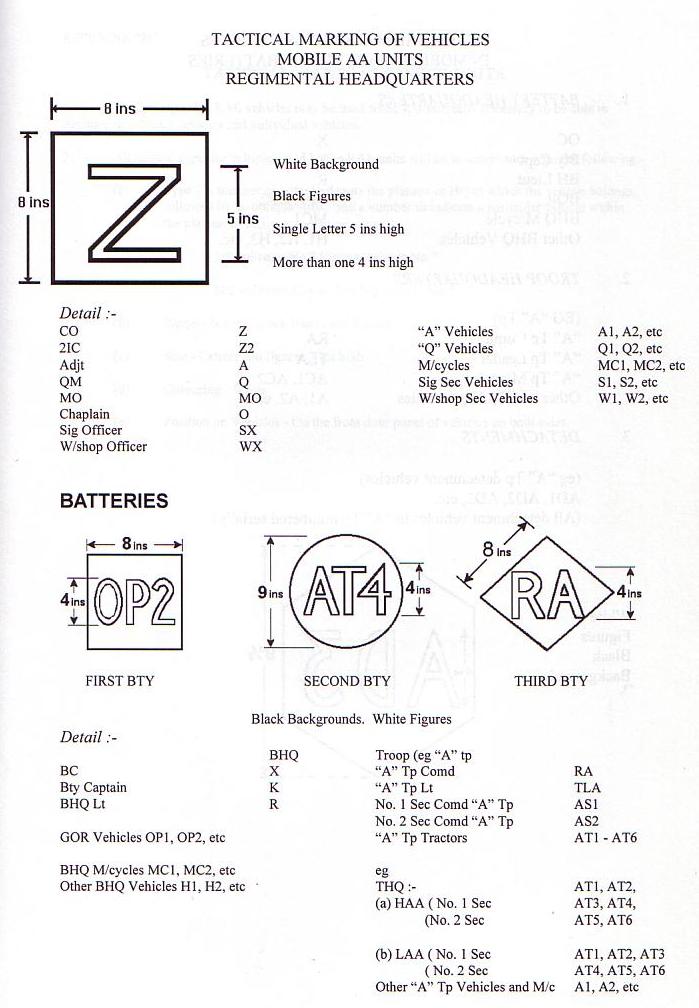

Among my photo collection I have a few photos of these 'Tac' signs painted on the doors of Australian Army Vehicles similar to the photo from the AWM below which was taken in Greece during 1941.
It always appears to be on vehicles overseas working with British forces and I believe it is a unit sign and not what is commonly called a Tac sign. It is also during these campaigns that the A.I.F. was more normally painted in front of the vehicle ARN as well so this would fit to the 'W5' painted on the door in the photos above.

The "S" in a square IS a mystery.
The W5 marking is the 5th Workshop section vehicle attached to an AA Regt HQ. Signals Sections vehicles will have an "S", but will be numbered, such as S1, S2, etc..
Old 26-10-07, 12:10
Keith's door shows the remains of a hexagon in the centre of the door. This is the type used for detachment vehicles of troop of a mobile searchlight battery (LAD, etc), and should also have letters and numbers indicating which Tp and vehicle number.
