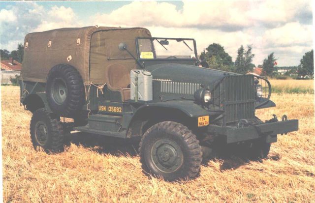

I have a friend who is ending the restoration of an INTERNATIONAL M2-4 truck (pic follows) in France. Unhappyly the front wheels cylinders for brake and the master brake cylinder are missing. Is a guy who knows the place (anywhere in the world) where these parts are avaible. Thank to any body for informations.

A very nice truck BUT parts may be very hard to find.
It is possible that the wheel cylinders and master cylinders are the same as thwe civilian KB International series. You will need manuals to identify the part numbers and search the civilain market.
EBay shows manuals at #360006790651 and a 1941 to 1970+ master cylinder at # 320151593875
Alex....... do you have the military manuals for the M2-4..?
I am sure that the parts are available if you could find the casting number..... but you need the parts for that....... or someone who has one restored.
Good Luck.

Looking back at the pictures......
....with the headlights very similar to the Dodge and the rims apparently identical to the Dodge WC battlefield rims......
.....is it possible the same source supplied the Dodge and M2-4 front axle as on a WC......?????
Alex can you supply the parts number so I can check with Malrmberg.
Boob
Old 03-01-08, 05:37
Default Are you 100% sure the truck is a M-2-4?
The photo of the M-2-4 (possibly a prototype) in Fred Crismon's "US Military Wheeled Vehicles" shows 6 stud rims that look more commercial/civilian than the combat/split rims in Serge's photo above. The caption for the photo in the book includes "The one-ton was nearly identical to International's half-ton M-1-4 except for lower rated suspension and five-stud wheels on the lighter models".
Is there any chance the cab and data plates are from a different truck than the axles due to a rebuild or mix and match repairs over the years? This might mean you need to be looking for parts to fit a M-1-4 instead of a M-2-4. I have no hands-on knowledge of the International trucks, so this is only a guess.

Default Check both pictures....
Grant... if you check both Serge's truck and the one posted by Alex are both fine stud rims...... that would make both 1/2 tons.
I would even gamble that the front shocks are the same as the Delco used on the cab 11 Chev and early Dodge WC......

About the battlefield rims of M2-4, I believe that the first series used wheels of DODGE 1/2 ton and later they were replaced by wheels of DODGE 3/4 ton.
I think that this truck is very particular in the fact that it has been built using parts from differents trucks. So, the frame is very weak and the axle are too heavy for the frame. These leads to exessive torsion on the frame.

That was my point, the M-2-4 is the one ton version and according to the Crismon book should have six stud rims. Serge's truck (and the Netherlands truck) has five stud rims and based only on the axles should be a half ton, M-1-4. I am still puzzled. I do like your idea of checking Malmberg if we can get part numbers.

Default Pictures can be misleading...
Bonjour Serge
I did a quick search on Olive Drab..... they show pictures of the M 1 and the M 2 -4 and both ALSO have 5 bolt rims.....
Serge in your latest picture.... they might be the regular M 37 Dodge rims which came after the heavy battlefield rims.
Dodge did have a 5 bolt rim (non-battlefield) I believe referred to as a Budd rim... with a clinch ring. .... and to further confuse things the same bolt pattern rims were used as a narrow rim model for the half ton 4x4 Dodge using 7:50x16 tires.....from the side it is very difficult to see the difference between a 9:00x16 Dodge rim and a 7:50 Dodge rim.....
Any chance of getting some close up pictures of the front axle..? such details as the flex joint steering hub..... center axle back side and front cover... and maybe the rear axle.......
You may have a hybrid in your hands..... it can still be made to look good and serviceable......
Bob C.

I send you a pic of the front axle and really I think that wheels and all other parts are original. I found other pics of M2-4 (all in USA) and all have the same wheels
Best regards Serge
Old 04-01-08, 15:03
Posts: 5,267
Default That settles it......
.... it NOT a Dodge axle........
Now we are back at finding a parts manual......
