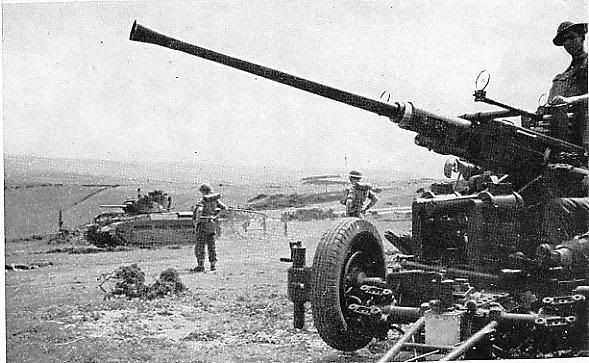

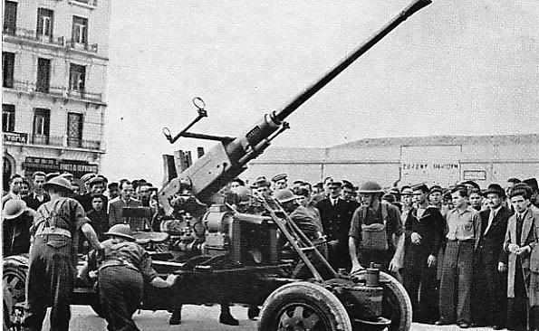

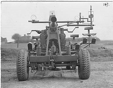

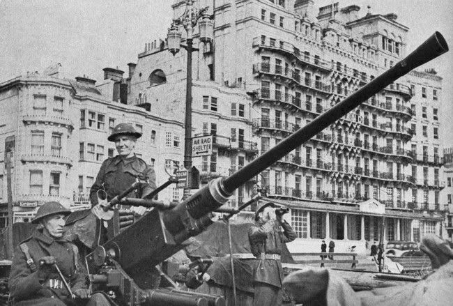

Below are some of the photos I've found (some from this forum!) that show Bofors L60s with similar sights - but, to my eyes, the proportions look different or the details are too obscure to be certain:
Maybe it's from a naval Bofors?
